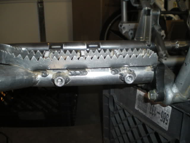

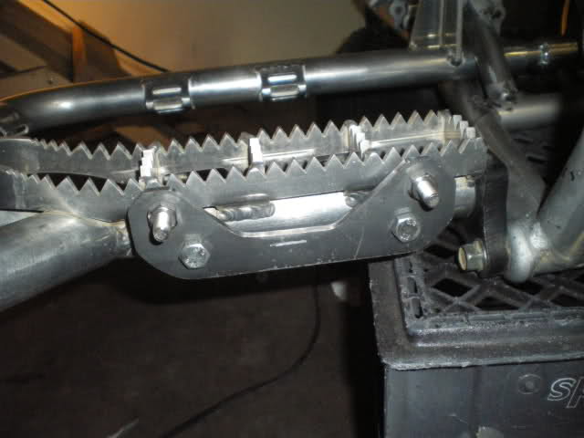

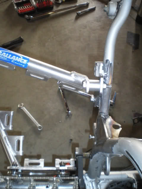

So here is my heel mount setup
First, is of the stock mount points in back of peg.
Second, is brackets that were cut to match up heel guard stock mount holes
Third, Top bracket which mounts to stock heel mount
Fourth, I had to take some 1" aluminum round bar drill it and cut it to make the spacer to fit to frame, It matches the bar of the heels so does not look to funny. I gotta get different bolts so it doesn't stick out like photo.
Last is the finished mocked up product. The brackets were made out of 3/16 heat treated steel so it is rock solid.
