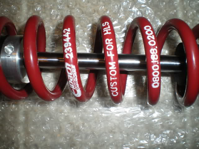

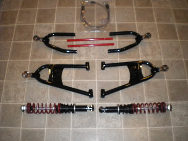

Ok, so pics are coming, I sold the engans and had gtthunder build a custom HLS shock setup using eibach springs. These were custom built starting with a yfz shock then lengthened to 16 1/4 eye to eye and adding correct springs and custom bushings to fit correctly to blaster with no spacers
Here is most of front end

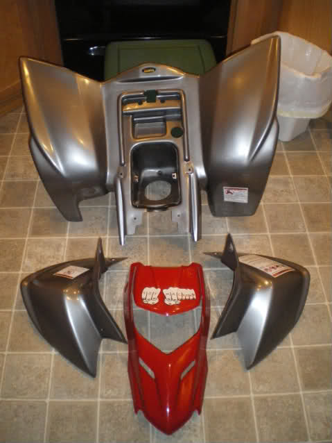

Ok, here's a picture of my plastics. Tank is missing, my wife is decaling custom "blaster" vinyl stickers for it at her work.

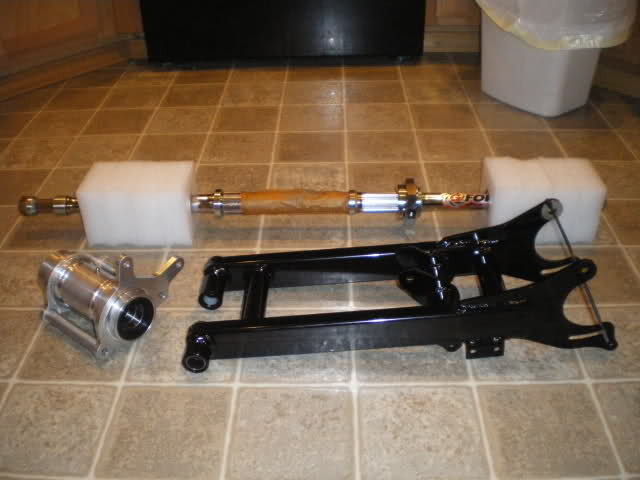

Ok hear is the rear end besides brake which is getting taken off my old carrier today and rear shock which is still up in the air
I love this carrier, I have seen some other stock style carriers but this one by far is the nicest stock style dual row carrier ive seen

NEED HELP PLEASE ....
Awk, maybe you know, but is there anyone running a g-force axle with 03-06 carrier?
The g-force instructions are vague and the axle itself has a blaster specific spacer but I am thinkin this is for 88-02, not 03-06.
If anyone is running a g-force axle with 03-06 carrier could you plz upload a close-up picture of it, or point me to a listing with one. I searched but could not find one in the forums. I will give rep points for sure.
Re: Finally Ready For Dream Build ... Need Engine Suggestions
i run that axle with the pre 03' and i used the spacer but im almost positive for 03 up and banshee you dont use it. only need the spacer for the old "floating disc"

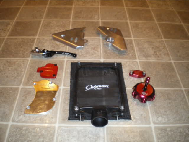

Randoms:
Trenga oil cover (aluminium), ASV lever for hydraulic brake master cylinder, outerwears with cut airbox cover (to hold on outerwears so no velcro need to brace it around with metal plate similiar to EHS), Works frame guards, Modquad PB block off, Tusk breather cap. Oh, and red powder-coated stock throttle cover.

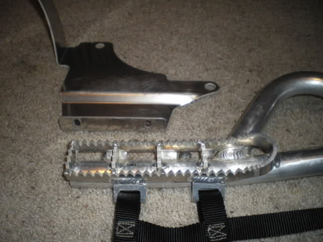

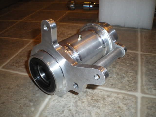

These are the nerfs/pegs i'll be using.
I will not be using these heel plates. They are made for the stock plastic heel guards (like stock heel plates), we are fabbing brackets for a pair (pictures soon)
These pegs are sick ...I:I

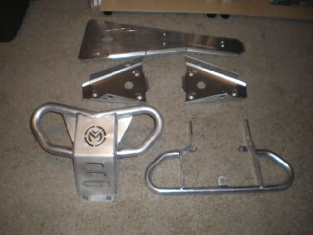

Some of the other aluminium :
I also will no longer use these A-Arm guards as I doubt they'll fit my new arms and I am slightly concerned about weight. Suprisingly the new swingarm is same as stock but axle is "heavy". Arms are adding equal est. weight in front over stock. Since I'm not planning on doing heavy engine work I gotta start thinking about weight.

what nerf bars are those? they look sick! is there like a mount that replaces the stock pegs? or do they bolt to the stock to make wide or what?

The nerfs are xtreme fabrications they are a small shop who does everything to order but come as pictured. I'll take pictures of mounts. I pretty sure I've seen others on here with pairs.
