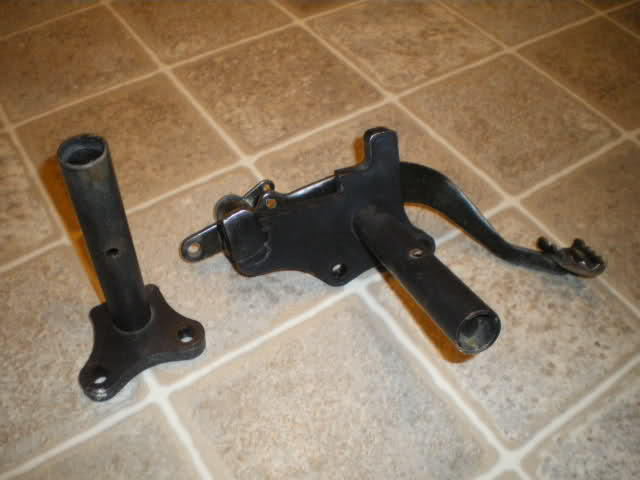

Here is the mounting part of the nerf bars, I just pulled em out so they can get painted before remounting
Here is how they mount you can see it half slid in, there is a bolt that goes through both holes once lined up
These have 03-06 brake pedal mount
The frame guards I bought new like two years ago from works connection. I think they no longer make them so might be hard to find. I've never mounted em, but they'll protect my newly coated frame nicely.

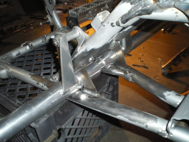

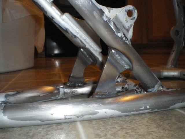

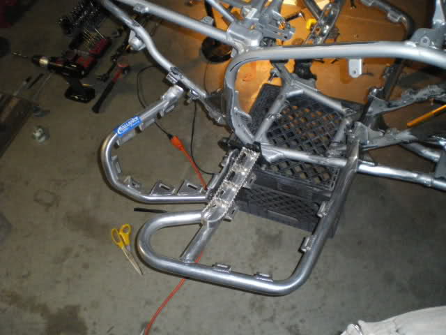

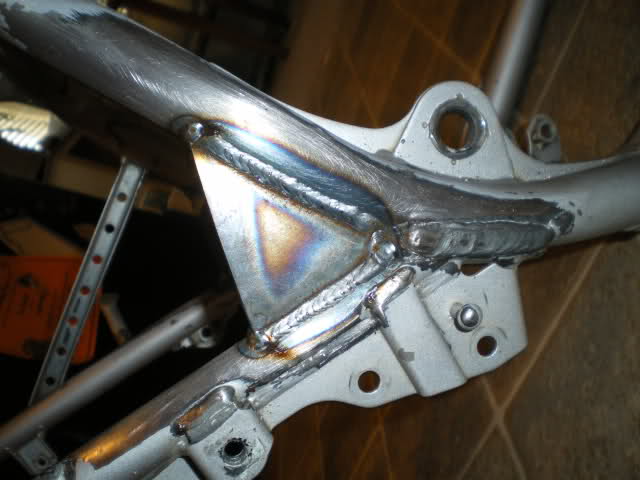

So, I was hoping to have frame ready by now but when things need to be right it takes time. So frame was at fabricators getting gussets welded when we ran into a problem. We had previously cut brackets to weld to subframe that allowed a pair of aftermarket ltr heel plates to mount correctly to blaster subframe. Anyway when we mocked everything up we had done it on stock pegs (this was before I had purchased nerf bars). After they were welded on the thought occured to me that the mounts would not work with the aftermarket nerf/peg setup I plan on running. So I had two options. Cut off mounts and reweld, or not use the ltr heel plates. So we rewelded the mounts and mocked everything up, this is where we noticed that the heel cup would not fit between the nerf bar and peg. Story short, although they worked with stock peg and looked sweet they were not a match for my nerfs/pegs. So I bit the bullet and we are gonna try with a whole new heel plate/cup. For 107$ I scored a NIB pair of REM/GYTR Bill Ballance heel plates with nets for a raptor 250 from twiggcycle. YFZ ones were 20 more But after looking through some mags at frame pics. I am thinking the 250 ones will be a better fit since they are smaller and also work with the new raptor 125 which are both in the blaster frame category. Anyway it's moving along and I will post pictures after welding is done.
On a whole nother note: TPR Tarantula gusset kits SUCK!!!. I will take a picture of the gusset installation paper so everyone who wants to make there own can, and knows through research the proper places to gusset. TPR's kit itself has horrible fitment, luckily they were all cut big so we were able to chop em down to size - took almost as long as it would have to cut our own. 2 of the 11 gussets fit ... And no gussets for stem area? Also if you run nerfs you'll need to recut two anyway depending on what brand. But yea for the price the kit sucks fully - make your own for sure.

Ok, I've finally got time to upload some pics, so here we go with the gusset and my heel guard mockup, I am still cutting the brackets to fit top mount in heel guard pic but check it.
shock mount gusset
A-Arm gusset and cross-brace
SubFrame Gussets
Trick Nerf Bar Gusset/Mount
Rear Gussets
Heel Guard Mock Up: Still working on top brackets (not welding/using bracket setup)

lookin good bro! jealous of the healguards and gussets. nice work inccorperataing the nerfs into them
Re: Finally Ready For Dream Build ... Need Engine Suggestions
Yea, Im really trying to make them look like one set, I've had some trouble getting the side with the welded fender brace to fit around the mount for the heel guard. I had a hard time cutting into the bill ballance heel guard to mod them to fit, but it had to be done. I'll take pictures of it all mocked up in the next day or two with pictures of the brackets, modding, etc.
