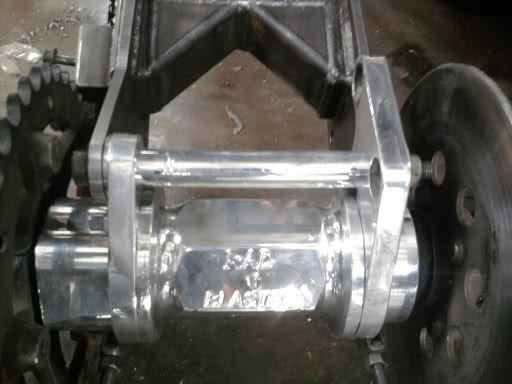

threw the rad carrier on the swinger and a stock axle in it just to get ken some final measurements on my bike, i insisted when he was building this, that my bike stay perfectly level, front to back, i didnt want it any lower, and sure didnt want it lookin like a trailer park 80's camaro on airshocks !!!!!!
so ken and i exchanged quite a few phone calls, and pics with measurements,

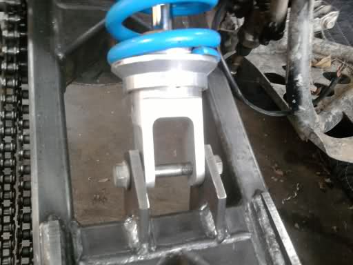

also this 400ex works ultra cross shock i have, is 1 inch longer than a stock 400ex shock, so tarmo had to fab this with that in mind
after throwing this all loosely together, i measured to my frame skid plate up front....
9 1/2 inches form the ground, does it surprise anyone that i have exactly 9 1/2 inches in the rear too, amazing perfection, considering he didnt even have my bike right there to fab off of
as for the fit of everything else, i may have room for a very thin washer on the shock mount, the carrier fell right into place and it fit perfectly into the frame and motor
this bad boy is spot on !!!!!
heres a few pics i snapped of it all just loosely in there, and right as i was cleaning up to come home.............the g-force axle shows up, that'll have to wait till i find a powder coater for this thing, and my new frame painted up
motoman to the rescue with postin pics for me below (thanx bro)\/\/\/\/\/
finally got the rest of my pics to upload showing how this all fits together perfectly..................
