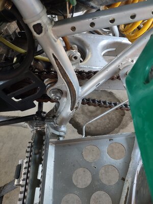

@RIDE-RED350r any idea why this thing "pees" after running it or if it's just sitting it lets out some fuel..? I figured out if I just turn the fuel off it doesn't piss on my concrete but just curious why it does this.
Fuel leaking from the carb overflow vent is one of three possible causes. Sticking float, fuel inlet needle and seat leaking/in need of replacement, or misadjusted float height. You have too much fuel in the bowl, this can also cause issues with fuel mixture across the board, including your issue with it not wanting to idle reliably.
Reactions: tibblits
