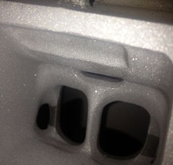

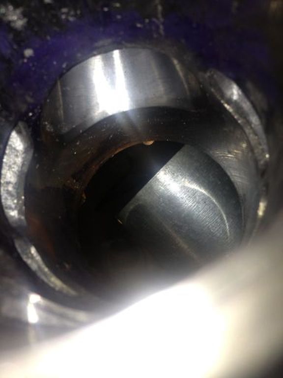

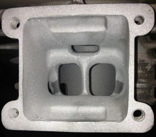

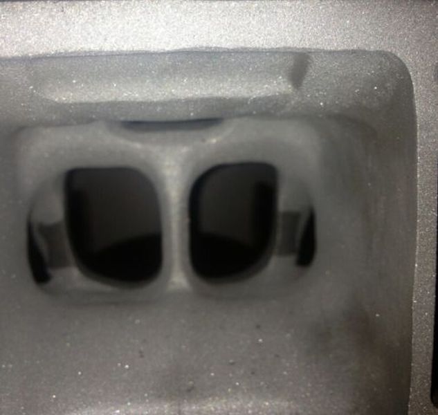

huge ass intakes and boysen ports:
and matching exhaust port:
yeah, that intake window has been enlarged for a different reedcage, the adapter plate gets welded on tomorrow.............
and no, nothing has been added or welded to the outside of the cylinder for those boysens.
this is similar to how the "big national" builders used to build 200cc class engines, but they would de-bore the engine with a smaller diameter sleeve and a stroker crank to stay at the stock displacement.
curious to see how it works out with the bigger bore!!!
something that also helps this is that the vito's rod has a smaller pin than what the stock one uses IIRC.

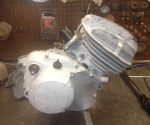

Tarmo spent a bunch of time on this build this weekend. We had to repair a few spots in the cases and decided to add some material to the intake sealing surface to make up for what we removed to use the CR reed cage. All of the machine work is done and we’re ready to assemble it. I’ll be shooting another vid of the assembly. The shop is crazy busy so Tarmo owns this one. He really stepped up to the plate on this “experiment”. He’s donated all of his time to help to help make this project a reality. He’ll be doing the assembly on Friday night and hopefully dropping it in a bike on Saturday. Not bad for a guy that got his start in Estonia with a box of Leggos. Thanks Tarmo!!!

fully assembled earlier today............
heat cycles in jess' bike by evening.......
