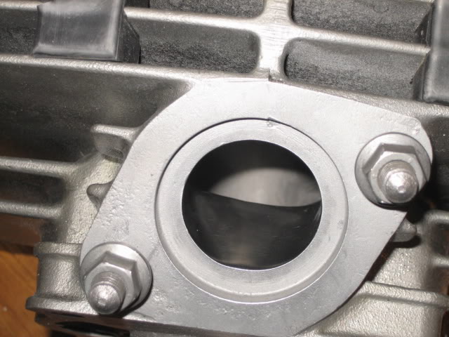

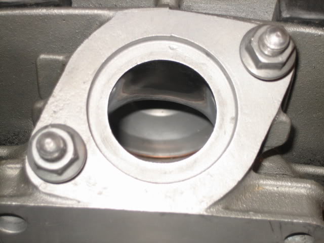

Excellent videos Ken! I have some port work that was done by Angus and he did a great job...so i expanded upon his porting by just sanding the inside of the exhaust port with 220, then 400, and lastly 800 grit sandpaper by hand. Then i polished it up with the dremel. So the slicker the better? It's a mirror finish if you can't tell by the crappy pics. what about the other ports? I will do them to a mirror finish as well...seems if the air has no drag on it then it should be easier to flow through and make more power, right? Or should i stop here...

As I understand it, you do NOT want a mirror finish on the intake, only the exhaust. I've heard that a rough surface on the intake helps to atomize the fuel mixture. I would assume the same would be true for the transfer ports.

That is what I was thinking V...I know a mirror finish on auto cylinder heads are a no no. I wish I could get some dyno numbers on the mirror finish concept vs rough cut to see how far the power degrades.
