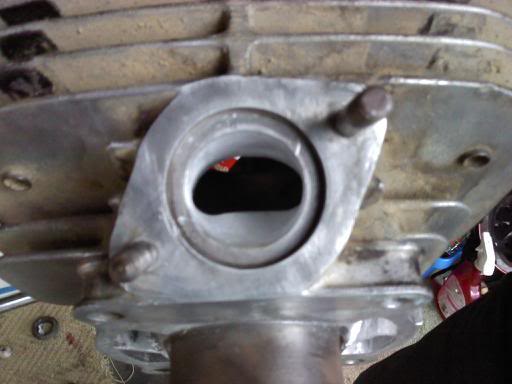

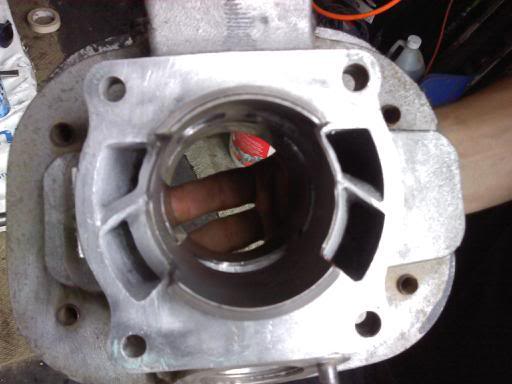

heres some pics of the cylinder that batt ported, some of it was done using kens vids and some was eyeballed off our flotek cylinders.....we added boyeson ports to this one tho, just waiting on the piston kit, and well see how she runs
oh yea, this thread is getting stickied.....thanx again ken

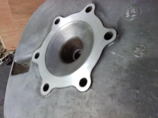

heres the head that was milled down on a orbital sander
this cylinder still needs lotsa work before its finished, ill get more pics when its done
