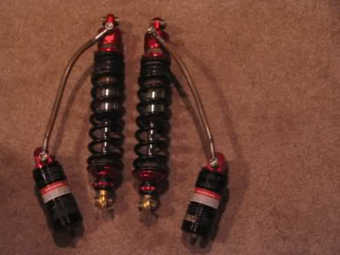

the elkas i traded the yfz triple rates for, thanx dually

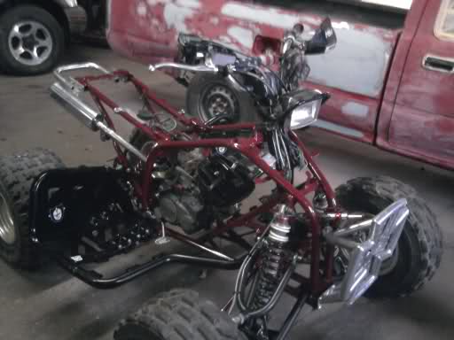

finally made some progress today.......
finshed drillin the new lower shock mounts and got everything loosly bolted up
woohoo !!!! my measurements were correct, i now have 10 inches of ground clearence up front, i had 9 1/2 on my old arms, same shocks
gotta paint them new mounts when my elkas show up, and the alignment needs tweaked the too
the pic is with the yfz front rims flipped, not sure if they will stay that direction or not, but it's 50" wide like that, i'm thinkin i like them the other way to better protect my calipers and all the suspension heims ????
had to tear that left nerf off to finish up the new pedal and get the master aligned right, and transfered my under seat rezzie from the old frame, still waitin for the new braided line to finish the rear brakes

Its looking awesome awk!!! If it was me i would flip the rims back to protect the calipers and the lower suspension heims... and i love your bumper!!!I:I
you might want to flip those rims back around, the bump steer will be terrible (even with your stabilizer) and also exposes your heims wayy to much
Man, what a mess with the shocks, new mounts look good though, and interesting to know it didnt f**ck up the PC. I'd flip your rims back too, especially with no brake guards, I love the pro armor nerfs the fab work is sweet, I'd be worried about the fact that your toes are gonna sit on the front bar, they don't look far out, might make shifting tricky.
looks awesome man. yeah i would flip the rims back 50" is mad wide for trail riding. plus you need the protection so the mountain doesnt eat your brakes and suspension lol.
