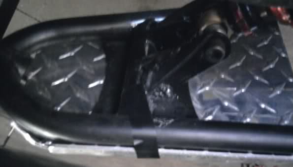

i knew i'd find a use for that diamond treadplate someday,...................

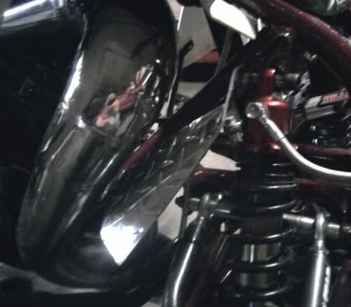

my style airscoops, that get the cool air behind and past the pipe to the cylinder

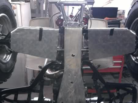

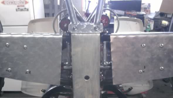

and some a-arm gaurds, they look huge from underneath, but are cut to exact shape ??? and just taped on in the pic, till i stop tomorrow and get bolts that will recess from the bottom
maybe i can skip off the huge rocks here better, hahahaaaaa
hahahahaaaaaa, duct taped a-arm gaurds !!!!!!!!!!!!!!!!!!!!!!!!!!!!
naw, used big ass 1/4" rivets for now, up into the flat plate under the shock crossbar, for a nice flat bottom, if they don't hold i'll counter sink flat head bolts and nuts, but they took a huge rivet gun, and seem pretty stong..................

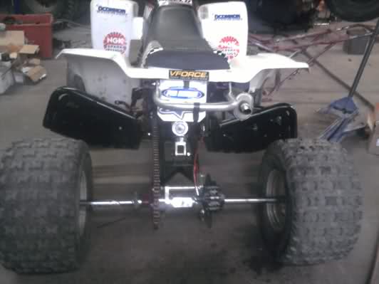

finally got the g-force in, and damn it's wide, 50 inches in back,
but i think i'm gonna like it ???? took it for a little test spin down the alley
never really needed wider, but had to match the front
i've never tipped it onto 2 wheels, no matter how hard i ride it, i came off of 2 three wheelers before i got into blasty's .......................

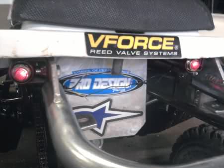

and also came up with a frame plug idea........ LED's !!!!!!!!!!!!!!!
found some brass fittings that fit really tight into the ends, drilled them for the leds,
and drilled a small hole underneath for the wires to exit, this pic is of the rough wiring, i fished the wire thru the grab bar from one side to the other, wired them into the disconnect plug i had wired in from when i had led's in my old airbox, and hid it in the grab bar too, so all the wiring except about an inch on each side is hidden............................
