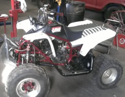

almost done, after 2 good weeks of pullin my hair out, but in reality i got alot done in just 2 weeks time, complete teardown, 06 frame... mounts welded on to fit my 02 parts, stripped and painted,
new.... gsxr brakes, swinger, axle, carrier, a-arms, all 3 shocks, nerfs all needing fitted and tweaked, and also the a-arm troubles needing new mounts welded on, and swicthing shocks with dualstroke
got a sh*t load done today...............

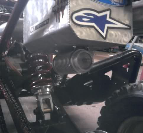

got the elkas on and the rezzies mounted the only place the way the line is turned would allow, rubber hose as a cushion between the frame and just ty-rapped for now
i may grab a proper dual mount in the future ????

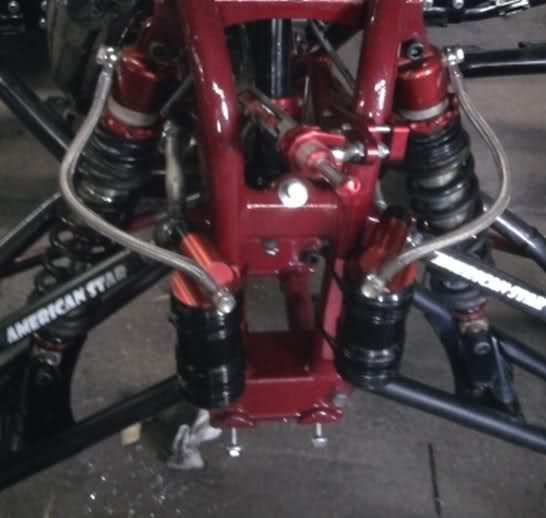

when i went to flip the rims back standard, aligned, tightened, cotter punned all the suspension nuts/bolts,
installed new front brake pads and noticed the brakes were sticking, upon further investigation saw that the braided cables were hittin the spindle, not allowing the brakes to release, then found the slides were really gummed up after 2 years on the bike, turned the lines, tore calipers apart and cleaned/ greased everything and re-bled, these puppies will do stoppies now !!

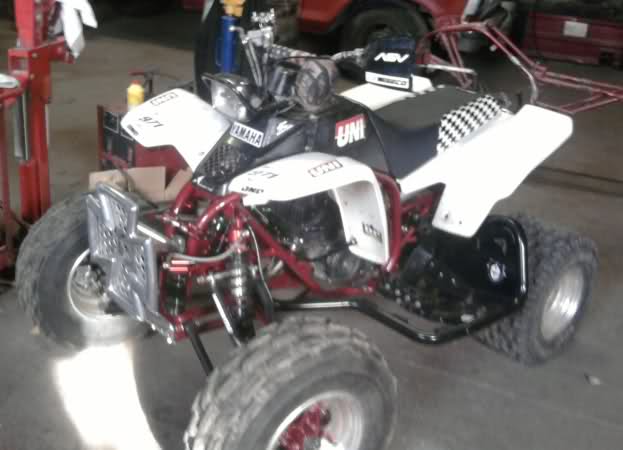

installed the pipe too, but it was riding too close for comfort to the nerfs, used my buddies porta-power to spread the front of the nerfs our further on that side, and pinned it in place with a bolt where they interlock in the middle
/\/\/\ yeah, thats my diamond treadplate in the backround, for a-arm gaurds and airscoops
installed freeks case saver which has been layin around for a year, did my sons as soon as i got it, but slacked on mine before, also got the banshee length red 0-ring chain cut and on, and decided under the airbox was the best fit for my rear shock rezzie, it's held on by 2 stainless steel ty-rap like bands used for cv boots thru 4 small holes in the bottom of the cfm box with rubber cushions
then got all my plastics cleaned a little better and on with the new seat, these huge ass nerfs and heelgaurds make it look like the rear isnt 2 inches longer with the +2 T-ROCK swinger, but i'm sure i'll notice it when i ride, maybe the front tires will get some wear this year
only a few small things left to do before a serious ass whoopin will be administered to it for all this aggravation...............
g-force axle spacers for the brake hub will be here on monday, the pics above are with the stock axle,
new brake hub boot/seals/clips are waitin for pickup at cernics suzuki, new braided red covered rear brake line is at moms today, goin down to make hspecers gsxr brakes tomorrow, and will do a new caliper bracket for mine while i'm there, my signature gold caliper is gone, goin with a 06 black one this time to match my colors better
and the nerf nets still need cut and fitted to the shortened nerfs, i lost 2 sideways strap mounts when i shortened them

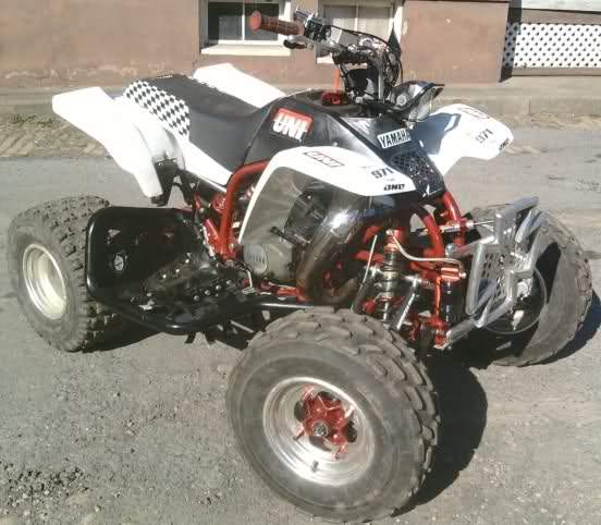

sunning itself !!!!!!!!!!!!!!!!!
but still no g-force axle spacers, rmatv azzholes, so again this is with the stock axle, and rear rims flipped < yeah that works on shee/yfz rims
got the rear brake done, nerf nets in <(they suck) and put my old frame skidplate on, still has some life left and 39" peices of aluminum aren't easy to come by
