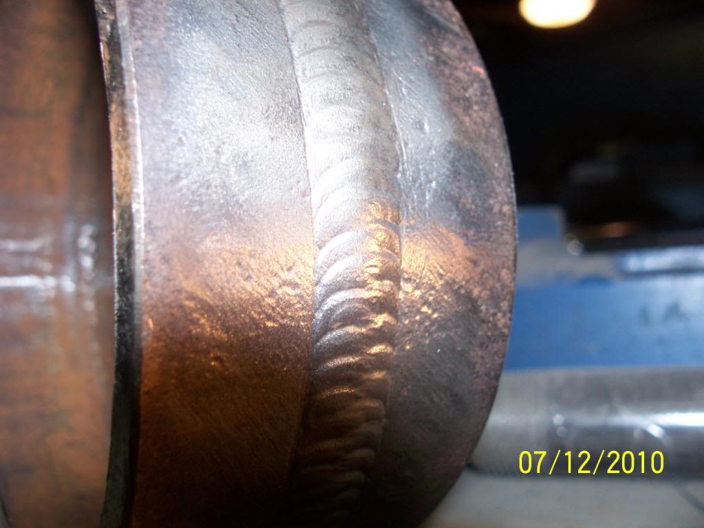

Feeding the filler gets harder when welding pipe or anything in a fixed position other than flat. Maintaining the proper filler angle is important also. I try to maintain the filler at 30° and I never let the filler touch the work. Here is my weld requalification on 4" sch 40 carbon steel some years ago. I walked the cup using CK's ceramic cup (gray cup) size 4 root through last fill pass then a medium gas defuser and size 8 cup for the cover pass. I freehand with alumina cups. Ceramics handle the heat better and less acceptable to thermal shock. Depending on the work, different cup sizes and tungsten stick-out makes a world of difference.
Feeding the filler gets harder when welding pipe or anything in a fixed position other than flat. Maintaining the proper filler angle is important also. I try to maintain the filler at 30° and I never let the filler touch the work. Here is my weld requalification on 4" sch 40 carbon steel some years ago. I walked the cup using CK's ceramic cup, I freehand with alumina cups. Ceramics handle the heat better and less acceptable to thermal shock.
wow very nice and great info. What position was the requal? 6g?
Requalification for Carbon Steel was 4" sch 40 in a 1-G and Stainless Steel requalification was 2" sch 80 in a 6-G.
