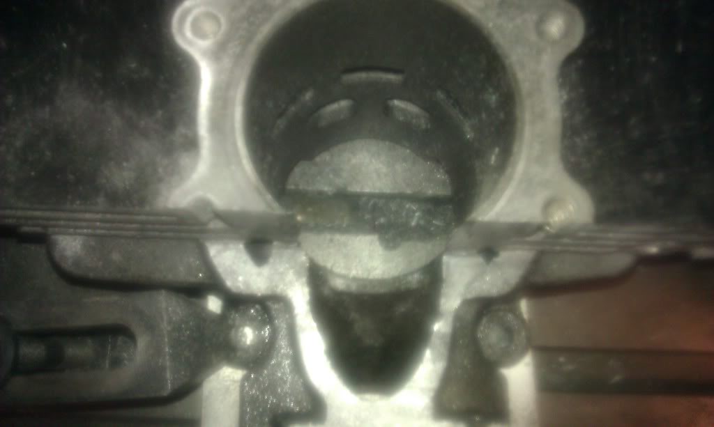

While the flotek triple port looks better looking down the cylinder, if the jug cannot have a hole any bigger than 1/4" (or whatever it can actually handle) then the pretty hole isn't going to be able to flow any more exhaust out of it.
I have a spare jug out there, I might just try this on it. Even a modest increase would be worth the time and effort.
if you come to busco this year you can ride mine and feel the difference if you like. its nasty for a 209cc engine.
No I don't doubt that the triple exhaust ports are great, only that the prettier more square port that flotek cuts can make a difference (in power output) over a simple round hole when the hole behind that beautiful square port is limited by break-out. The tunnel itself can only be so large... besides being far more attractive, I doubt the beautiful port makes more power.
the shape and angle of the ports play a big part in a strong engine...thats all im saying on that..
n8t heres a better illustration of what im talking about,instead of having them sharply angled straight into the main port try blending it in like i have the red lines

i was considering doing more with them but i got burned out on porting and wanted to ride it. every time i touched it i saw room for improvement. it was like an ocd for a week.I will definitely contour them a lil more. Mine are closer to the red line contours you suggested thats why i start back away from the cylinder and cut in sideways before i push for the ports.
gotta give props to whoever attempts this mod ,you guys are brave souls ..it takes a long time to do them right and is very risky to the untrained,i had lots of practice on junk cylinders when i first did them years ago ,i spend about 12 hours doing them on one jug but i do them abit different than most,the port timing and duration is the key to making them perform,having the pressure drop a certain way and time is critical to a wide powerband,just like the banshee cheetah cub you do not want to run the same port timing as you do a single mono exhaust or youll end up getting get a very peaky sudden hit at midrange through topend instead of smooth torque,having the chordial exhaust width gains lots of torque but the sudden drop in pressure and extra port area can hinder the overall efficiency if not done correctly

Here's what you got to play with boys. I decided not to use the band saw to cut this cylinder up and went with the Bridgeport instead. Set it up with a long end mill and ran the auto feed while I was doing other things. Not a bunch of material to work with. I like the idea of welding on the outside wall to build the casting up. You won't see me doing these anytime soon. Denny knows his stuff and if it takes him 12 hours to do it.................I'm not going to be able to do it any quicker without designing special jigs and tooling. I was lucky enough to have a aftermarket cylinder in the shop that has the triple exhaust ports cut into it. The ports are almost .500 in diameter.
