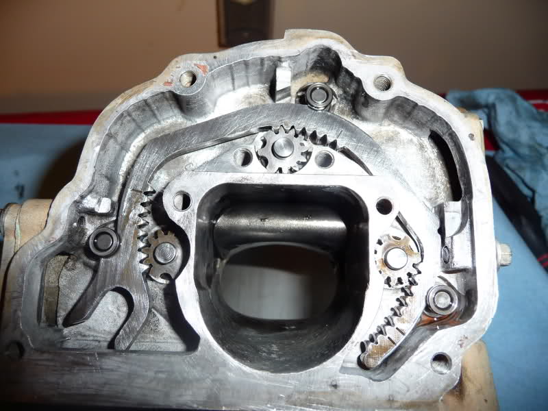

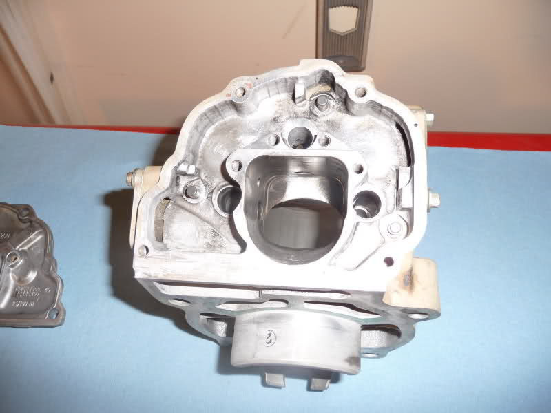

For what it is worth, the KTM 125/200 uses 3 port exactly as you are building here, only with a twist.
They have a tube inside that port and twist it to open or close the side ports with the powervalve.
The two side gears are tubes with a hole in the side that matches up with the hole into the exhaust port.
They are closed at low rpm and open by a centrifugal governor working against a spring.
The diameter is still quite small, at about 8mm.
(the small upper holes are the powervalve pivot, the top one its actuator)

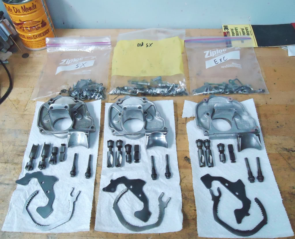

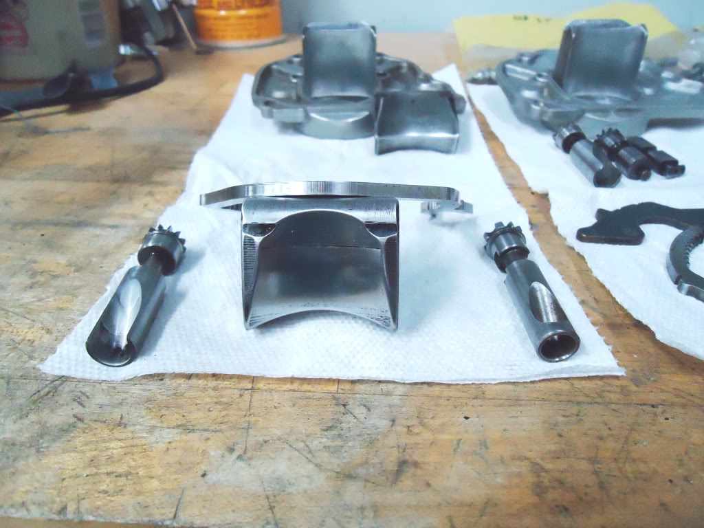

I thought I'd add these photos of the tubes that go in the side ports:
