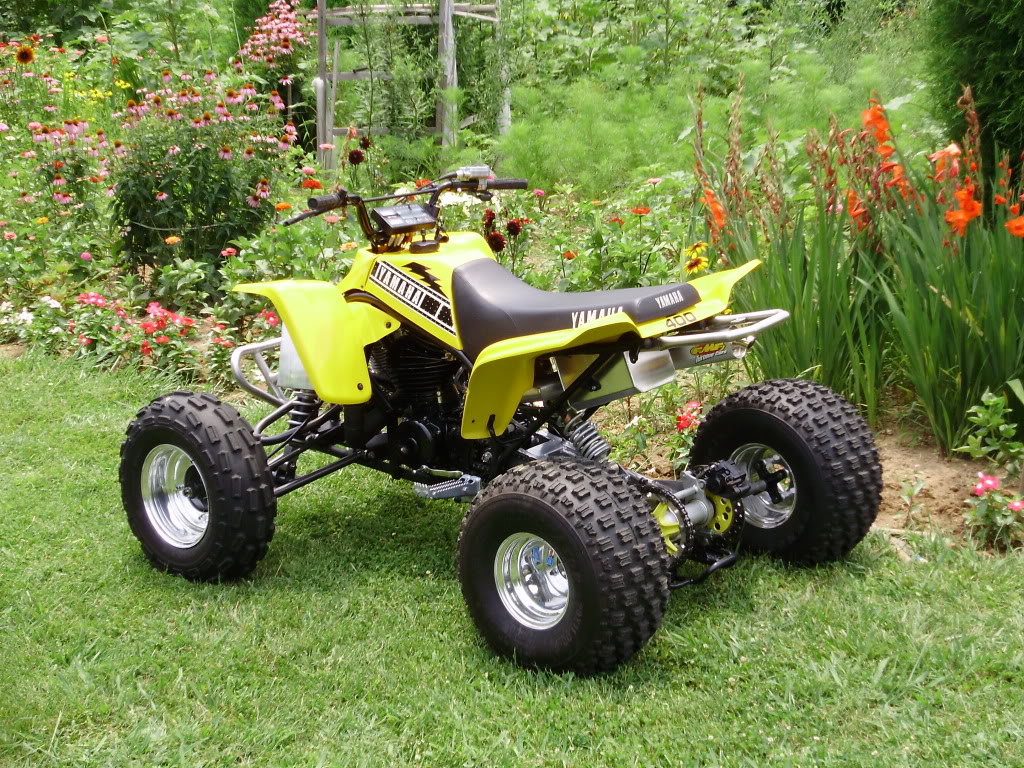

that is not 100% true paulie. the swingarm is angled and when you increase the length you will get a slightly higher ride height at the rear of the machine. a +3 +4 brings them up about 3/4". it does not change the handling charictaristics much at all.

Ya know, I was gonna stay out of this, but feel I need to share my experience to help elvis (or anyone else using any extended swinger)....
My sons bike came with a stock 4" extended swinger and stock shock, cut and lengthened behind the stock shock mount.
it sat at least 2" higher than my stock swinger on a 400ex shock,
and was way more "tippy" than at stock height.
(mx quads are stock height or lowered by the 18" rears and 19" front tires, not raised)
then when I put a 250r shock on my sons, it sat 6" higher than mine, (jacked up just like the camaro posted above)
I had to move the shock mount back 1", (pics in my albums)
which lowered it about 4", putting it back to the 2" higher than stock height,
so from my experience...1" back mount = approx. 4" ride height
on a 4" extended swinger
I then went to 22" front tires to even it out some and make the whole bike sit higher for the terrain I HAVE TO RIDE IN.
(not like i have a choice)
So from my experience, just lengthening the swinger and elvis' slightly longer 400ex shock, his overall height gain has to be more than 3/4 - 1 "
(i doubt even elvis would have noticed only 1", let alone noticed in the pics posted)
modifying a 400ex shock has never been needed,
it's a direct bolt on with bushings, with only slight height increase on a stock swinger. (i've personally had a 400ex and 450r)
cutting and drilling is a common fix for using the way longer yfz shock, not the "ex",
but may work in this instance,
but I did discuss with Elvis that drilling the 400ex the allowed approx. 1" is prolly gonna lower it more than 1", and that he should set his ride height desired, then mark where the shocks mount needs drilled, not just drill it up as far as possible, like is common on the yfz's and hope it works
good luck elvis, and holler if i can help ya anymore

without going out and checking i will tell you a very close estimate as to what elvis ride height is.
+4 extension + 3/4-1"
400ex shock + 1-1 1/4"
elvis total additional height out back 1 3/4" - 2 1/4"
the changes that will happen when you have this type of extension done is a little lift to the back of the machine. more so when a longer shock is being used. now do you understand?

I get if you use a 400EX shock and get your stock swinger extended +4", you can gain up to 2 1/4" of height out back (estimated).
