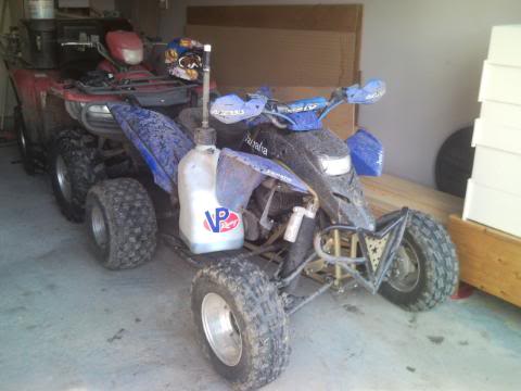

Specialized's 89 Blaster Build
Thanks man, She will have the DT200 in her soon. Was playing with rad mounts. Kind of like the idea of it behind the front bumper upfront.
So my 240 motor will be forsale.
Its stock stroke with a ported 240 kit anyone interested?
Well Couldnt resist with the warm weather, i had to skip work and bust out the blasty.
Finaly got to really test everything out.
This pipe is definantly a top end pipe.
It pulls much harder in the high rpms. But my mid throttle seems rich.
The tater front a arms are awesome. Front end rides much better and KFX 450 shocks are great. No complaints.
Im loving taters extended swinger aswell, feels like a whole new bike now.
I have a list of stuff that i noticed though:
-both left tires keep going flat.
-missing a arm bolt lol
-silencer was loose
-axle needs to be tightened up a we bit
-rear brakes need to be bled and tighten up fronts

im digging that kingquad in the background lol I:I
nice build by the way!
i cant wait to try out my cpi bbk pipe i am really stoked, ken says they are sick as hell, should sell that crap and get one!!! j/k they seem to be a good pipe, i knowm y lrd was an awesome pipe all around, glad u like it though!!
hahahah yea man that would suck.
i got a few things to do to the blaster thats for sure though. shes awful rich and that missing a arm nut is kinda scaring me.
