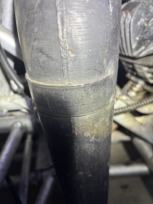

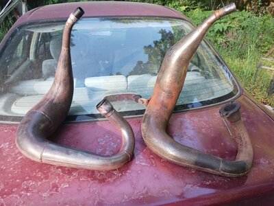

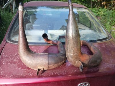

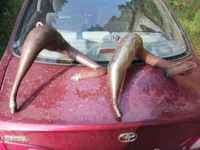

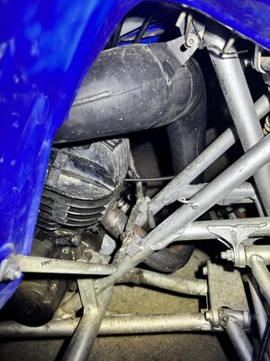

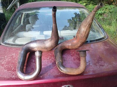

Id like to know what pipe this is on the left? It has no identfying marks?.. it and the muffler that came on the bike look very old. I bought the quad from a guy who didnt know alot about it really, it was his sons quad and had since got a older yfz450. Got it for a steal, and on the test ride it ran really well, but it had gobs of top end and really came alive in the upper rpms, much more then most the blasters ive ridden with fmf kits on them. The pipe on the right is a older fmf gold series that came on another blaster i picked up for refrence. Any input would be much appreciated

I looked through about 100 pictures of old production blaster pipes and it looked like a bill's, does yours have any markings? Idk what the silencer is though.. it looks like a vintage aluminum cr500 pipe hah and someone put a fmf sticker on it.

It’s to skinny to be stock but with no markings idk. Only thing I can think of is a bills where it’s not stamped but the four corners on the plaque are spot welded. Is there a spot where it looks like something might have been welded on?

How many springs attach it to the exhaust manifold? Mine only uses one spring on the top. That looks identical down to the bracket on the top. The bills is very similar to a toomey b1, and looking at the 96 pipe shootout, my silencer is deffinetly a older fmf powercore pipe, they even used the sticker just like mine back then hah
Well its not the bills either after looking your pics over, the stampings are diffrent and yours develops the chamber a lil before mine, and way before a fmf. This is why theese pipes come on so strong in upper rpms, and also why the fmf has sucha broad low/mid power band but lack up top. I bet that bills is perfect for my riding style
Well it’s not the bills either after looking your pics over, the stampings are diffrent and yours develops the chamber a lil before mine, and way before a fmf. This is why theese pipes come on so strong in upper rpms, and also why the fmf has sucha broad low/mid power band but lack up top. I bet that bills is perfect for my riding style
