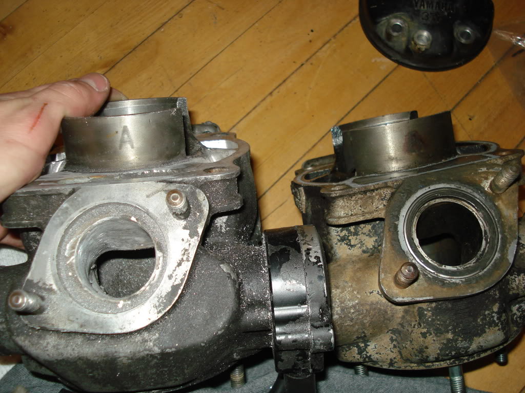

well got the cylinder and head off tonite. Everything looks good. Head is a little pited as well as the top of the piston. But it looks like the stock piston!
Going to have the head redesigned, cylinder ported, New piston and rings.

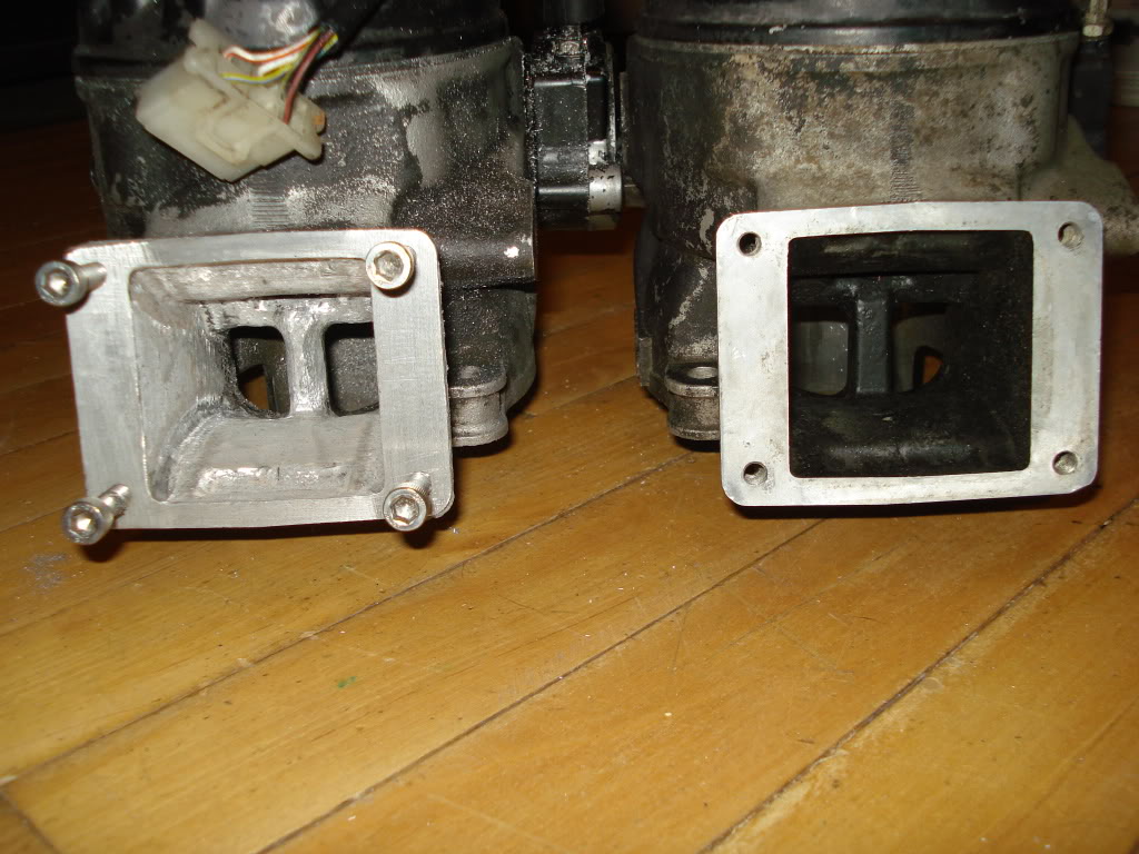

Another weird thing i noticed is it has Metal reeds lol . so i will need some new reeds forsure.

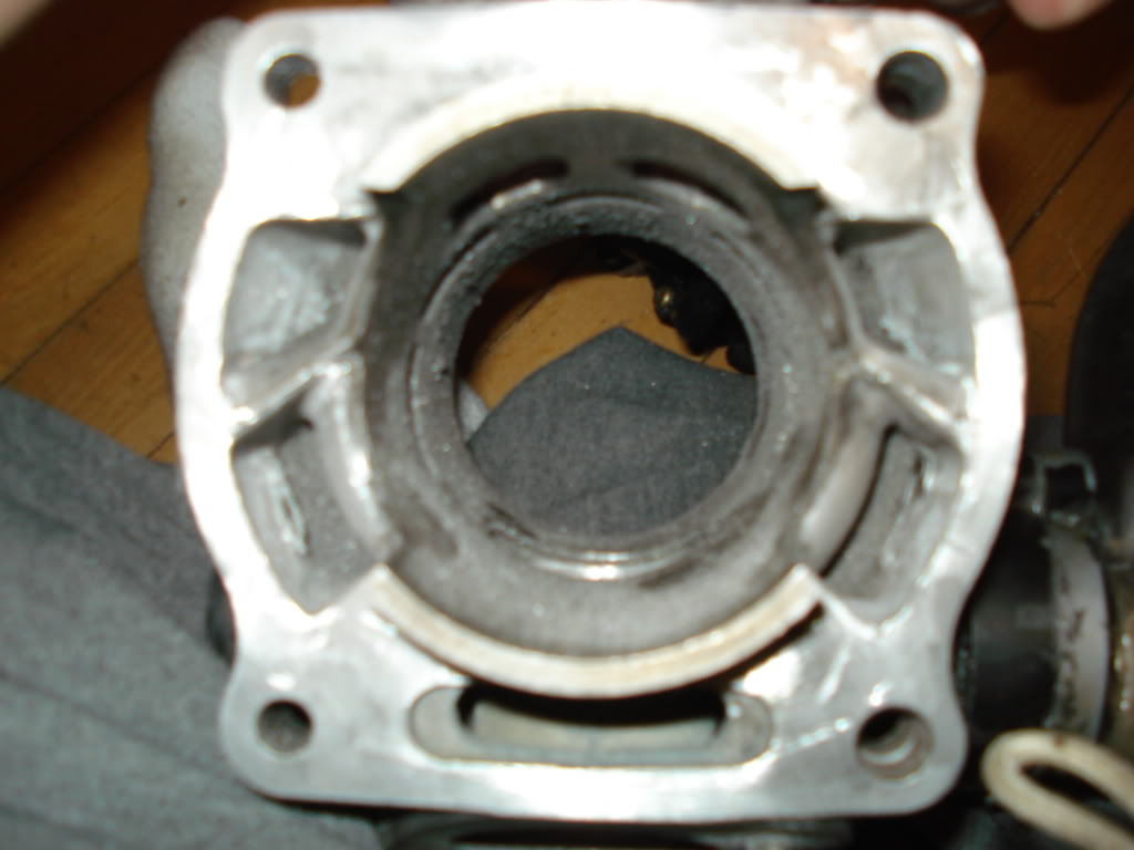

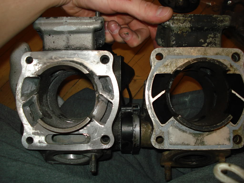

Well decided i cant send it out for porting because im going to mexico soon so i went and bought a dremel with the appropriete bits.
Cleaned up the cylinder quite a bit.

BTW the other (stock) cylinder in the pics is forsale

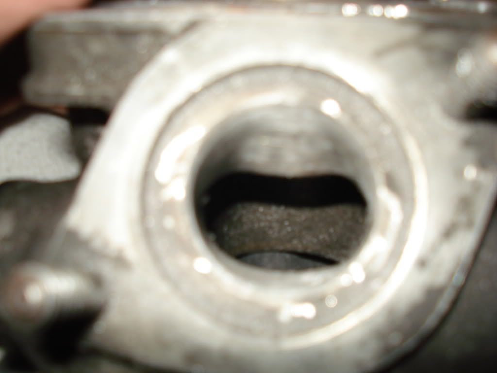

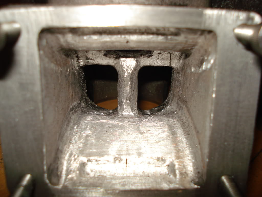

i didnt raise the exhaust port at all because of the powervalve .
i just narrowed the brindge in the intake and opened up the transfer ports

Anyways i did some more porting on my cylinder then i took it to R&L motorcycles here in Saskatoon they said my portings look good for a first timer.
