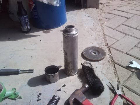

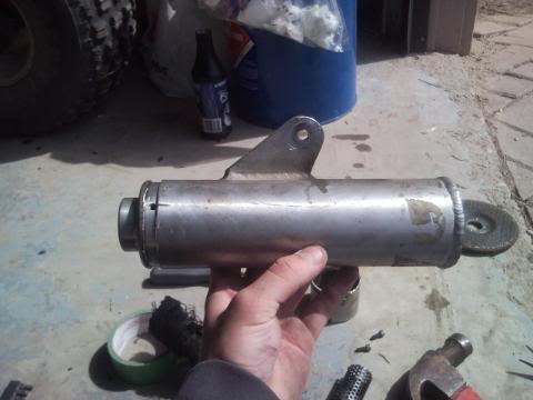

speaking of which i cut it down 2"

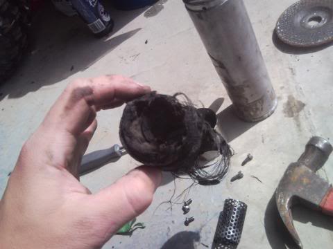

And i found out why this pipe is so damn loud.
haha barely anything left there.
Also i fired it up wihtout the silencer on and HOLY f*ck is it loud!

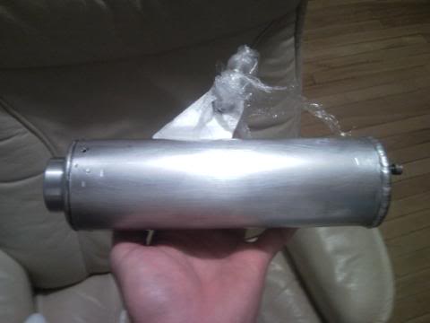

the silencer slipped on mine yesterday and ripped the coupler and i'll agree, its LOUD without the silencer attached
Yea i cut the silencer back 2 " because it was pretty much at the end of my grab bar (which i dont like) If i were to fall back on a wheelie it would have banged up the silencer pretty bad.
Im picking up some FMF pipe packing tomorrow.

Also i got a moose racing exhaust packing kit today so i repacked the silencer. Im kinda excited to see how much it helps with the noise.
