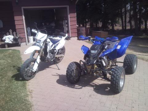

Here she is with my New 2008 Suzuki DRZ 400 SM

Well the 440 i ride with doesnt stand a chance anywhere in the trails. In a straight away his will top out around 125km/hr where as mine will do 110ish km/hr but i will beat him all the way there.
also its a custom intake i made all k& n with pre filters 14/39 gearing with boyessan pro reeds. and 20" tires
