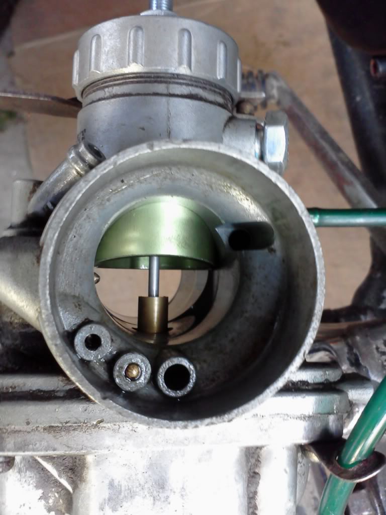

So, here is some more info and questions to those who know. I've replaced my carb cap, as posted above, but now it seems I don't have the same amount of throttle that I had before. My first question is, this pic is with the throttle pushed all the way until a mechanical stop, is it WFO? I'm thinking not, but I'm not 100%.

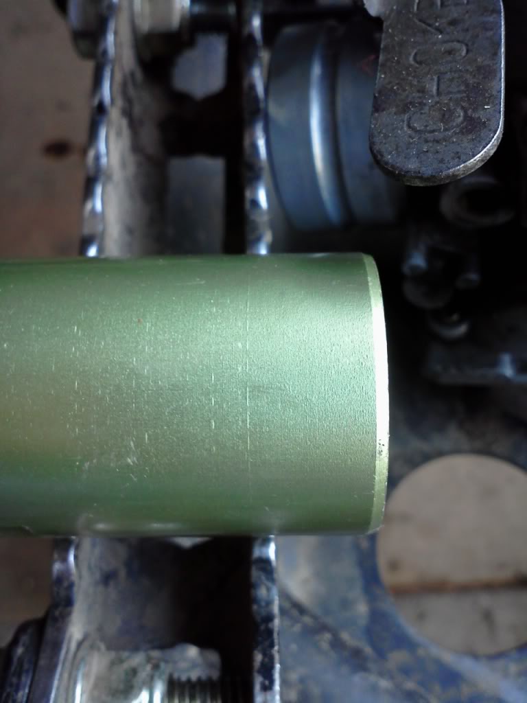

Next question, considering it is not WFO, I got to looking at the slide, and there happens to be a mark going all the way around it, in the pic you will see it just about line up with the foot peg. Did Mikuni (and/or other carb co's) make the mark for TORS removed caps? I did a quick measurement, and by golly this seems to be a good mark in the difference in heights of the caps (old vs. new). It just seems I would have to attempt to cut the slide and then it seems the first picture would appear wide open. Is this something that needs to be done when you remove the TORS?
Stupid question but did you slacken off the cable adsjuster, it looks like a lot sticking out of the top.
Nope, good question. I kept adjusting out both adjusters, top of carb and on the throttle, both backed out quite a bit. Anyhow, I kept adjusting them out until there was no play in the thumb throttle.
Bumping for night crew and to ask, again, is that line on the slide in the pics above, the line I should cut at to fit it for the TORS removed cap?
No, you do not cut the slide for tors removel. There actually should be a little slack in the cable, thumb lever should move a hair before the cable moves. Going have to double check everything. Is the thumb lever moving fully? Is limiter screw turned in or out?

Limiter Screw is backed all the way out. No, the thumb lever is not moving fully, because of the range of the slide I'm assuming. If I disconnect the cable from the slide, the lever will move all the way...but connect the cable to slide thru the cap, and it is limited. The slide does rest at 0 when the cap is on the carb and the cable is connected, so the cable length isn't an issue, it has to be the combination of the length of the slide vs. the height of the cap. Essentially, if you look at the caps in this pic, you will see a height difference....new cap on left and old cap on right. The slide will fit inside the extra height of the old cap.
Well you said tors cap I ASS U MEd it was stock carb, you're retrofitting something else :o At this point I guess you could try cutting the slide. Be sure to bevel top like original and de-burr it. Will the slide even be long enough if you cut it? Won't fall off tang that keeps it from spinning out of posistion?
Ok, knowing it's only $$$ to replace it, I cut it to the dotted line around the slide. Actually, I cut it short of the line, ground it down the rest of the way and then bevelled and deburred my cut. Now it opens up nicely at 100% throttle, closes perfectly at 0% throttle. I'm thinking, but I can't be certain, that that dotted line was indeed for accomodation for the different caps. So, now we all know another little trick I suppose...buy the slide that has the mark on it. I:I
