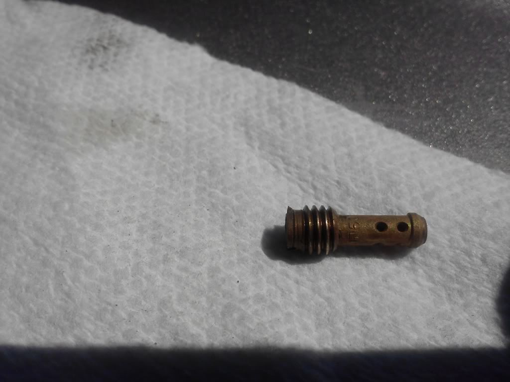

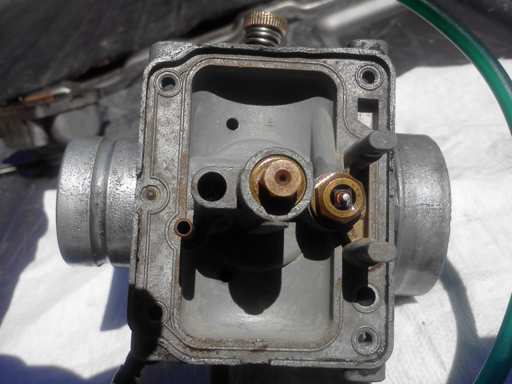

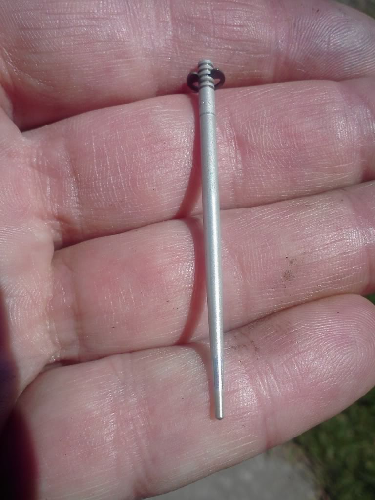

Ok, here are some photos to prove my sanity...well, what's left of it at this point. I will say this, I got the best quality I could, and they are as clear as I could get them....50 pics on phone to prove it. Also, I did notice on every part (needle, pilot, slide, main jet) that there was that box inside a box symbol stamped just before the number. I think that is what has been making it so difficult to really determine the numbers. So anyhow, without further ado...
needle and seat 2.8, main jet #150
pilot #50
needle is set at the middle clip position

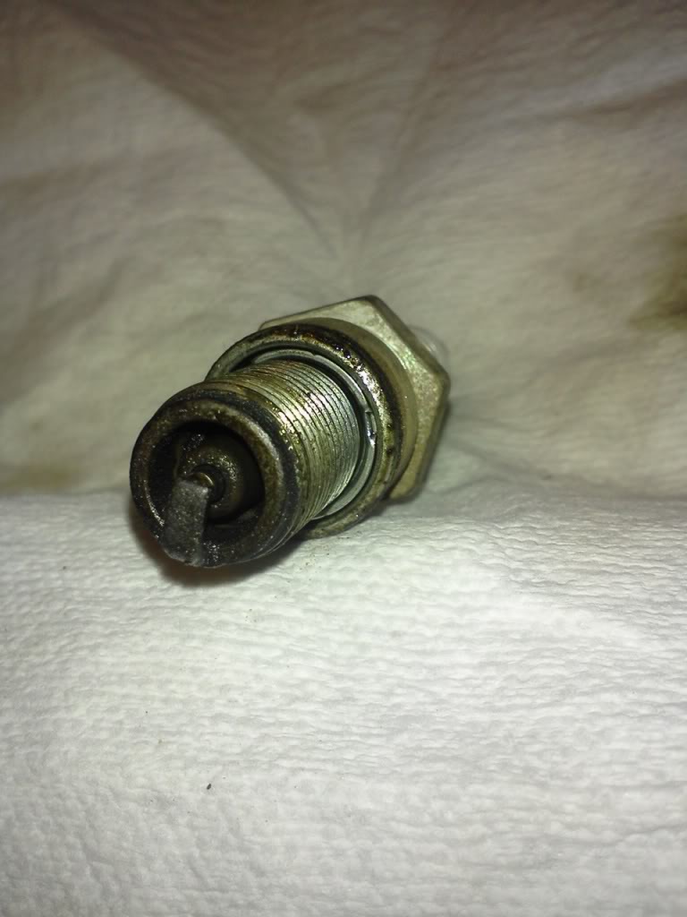

So, now this brings up some more questions, a #50 pilot??? The largest I've read you fellas talking about is 35. I guess I will also add, on the air screw, I turned it in 1.75 turns...of course then turned it back out 1.75 turns. Also, and I don't want to add to more confusion, but I read a lot about some guys going without the airbox lid, other than possibly allowing more air thru, what is the advantage of this? Wouldn't running without the lid allow dirtier air thru? Oh yeah, one other thing, the air filter is a stock air filter from the Yamaha dealer, pre-oiled. My next step is to run a compression test and check out the plug...gotta read up on the plug chop first though to know what I'm doing there. Just gonna check it out, not actually gonna do the exercise...other than the plug inspection.
Hoooowwwww the HELL did this thing even start let alone run without backfiring and spitting and sputtering???? LMAO...I've seen fouled plugs before from my old Camaro, but this is the worst I've ever seen.
They probably tried to compensate the pilot with the main, Maybe???
Pilot will feed fuel thru all of the throttle range but only effects idle range the most.
High pilot numbers usually indicate air leaks being compensated for. But that main is really low for the blaster motor in stock form. Unless they did a taboo and drilled it out to fatten the jet out. I've heard some will do that.
But like I said before the jetting will be similar to the stock carb, But the main more than likely will need to go up one size if at all from my experience with mine on a stock motor.
