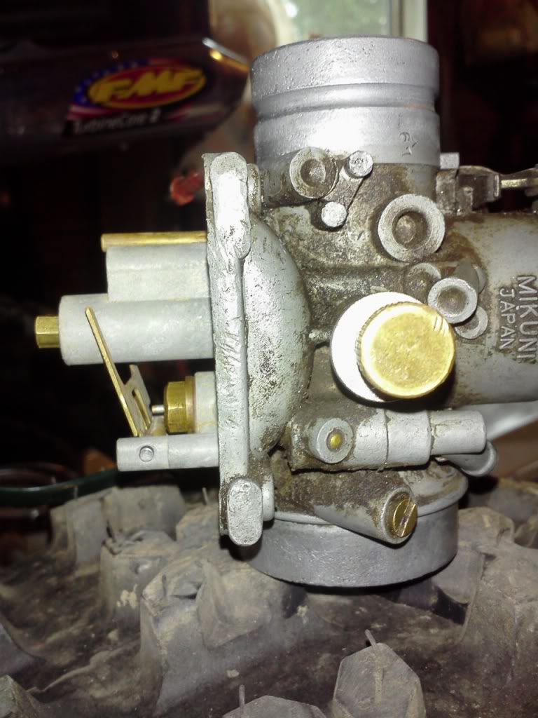

If I call you thick, then I don't know what that means you get to call me. LOL If you look at this pic...
you see how they are on those little posts? The posts are the shiny silver rods, they are part of the float bowl. The copper/tarnished cylinder that is around the posts, those are part of the float itself. That is what lets them float up and down by fuel level. Then, in this pic...
see that thin plat that is at an angle from the gray part, that is the plate that the floats hit against and push up to shut the needle and seat. I know, very confusing...of course, I don't know much, so it all confuses me. Anyhow, if you look at the floats, they are kinda tapered going to the middle of the float bowl, that is kinda what hits the flapper is that tapered part of the float. There is nothing that links them together, they float independantly. I guess that makes it easier if you're side hilling or whatever??? IDK.
No no no, never mind...I'm tired and being an idiot...the copper pegs at the bottom of the float is what hits the plate...not the taper in the float....been a long weekend.
I will say this tho too, that long copper/tarnished pipe that sticks up from the bottom of the bowl, that is the bowl bent pipe, that will let fuel trickle out. I wish I had a good side pic, but I don't, but that pipe is just a bit taller than the gasket on the bowl...so the fuel flowing in is just barely higher than the gasket, that is why it is trickling out. I have thought about bending the little tab on the flapper that hits the needle just a whisker to see if that will keep fuel from trickling out, but I don't want to mess with it too much.

Sorry, couldn't resist. Yes, I've looked at that quite a bit, learning and trying to make sense of it all. I'm pretty familiar with it. The exploded view is a bit misleading, showing that flapper plate down there by the floats, but it should be up with the rod that holds the flapper plate to the posts that is in the top half of the carb.:-/
yes....bend the little tab up towards the top of the carb, ever so slightly, that will allow that "plate" to push the float valve closed earlier, and lower that fuel level to below the "overflow tube"

Page 12 tells how to adjust float level. Fig 18, easy peasy!
