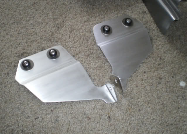

So as stated, after riding through the breakin and tuning I had noticed a few areas that could use improvement. Mainly, was the fact that the fender guards I had made followed the original fender mounts and angle and truthfully they stuck out forward from my heel guards. This posed two problems, the first was the angles did not match up (ran forward of the heel guard), the second was it gave little room for kicking and my legs were also rubbing against them constantly. If I was to move my fenders back it would be strictly for the reason of opening up the leg area. I did not do this however. Instead I cut the fender mount off (the mount welded to frame), cut my fenders straight across where the hole was on the left (which was the whole reason for messing with my fenders in the first place, slightly shaved my fender sides (towards the bottom) then rebuilt matching fender guards out of .190 Aluminium. I chose to brush the aluminium and remove the stock fender mounts as the new guards do a better job of mounting the fender stiff. They also cut the fender straight down (same effect as moving fender back) as you will see in the pics so they match the heel guards and also give about two inches of extra room where the normal fender would typically hang over the heel guard.
So yea pics -
New .190 Fender Guards -
Mounted - (before going on quad)
New Fender Guard (Front View) - Also Shows Fender Cut and Two Bolt Mounting, fender cut, and brushed finish
Side Angle so you can see how the fender drops off straight, you can also see how I used a small (1/4inch) nylon spacer between the fender and mount, there was a few resosns for doing this (mainly having to do with the bend in the fender that still remained in the previous hole side) Shown in second pic here.

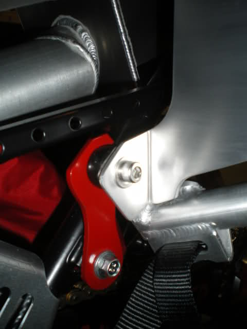

The mount is all one piece utilizing the bracket and mount already made for the heel guards, I took a good amount of time to make everything match up perfectly (as you can see) Plus, as stated, no stock fender mounts as the guards mount the fender super stiff
I removed both fender mounts as these now do a better job, since the Heel/Fender Guard brackets rest against the mounts, I left roughly a 1/2 inch on the welded mount side when cutting it off and finished it with a rubber cap (shown here)

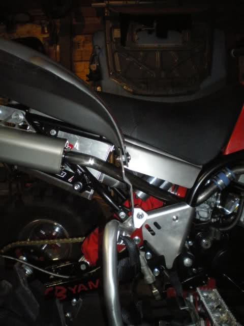

Side Profile From Rear
Side Profile From Front

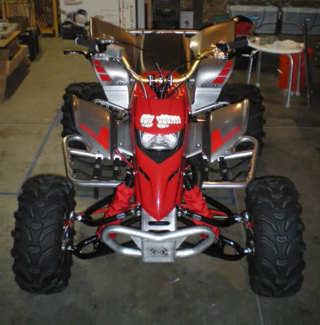

Full Front Profile (Top View) You can also see front fender decals ...
