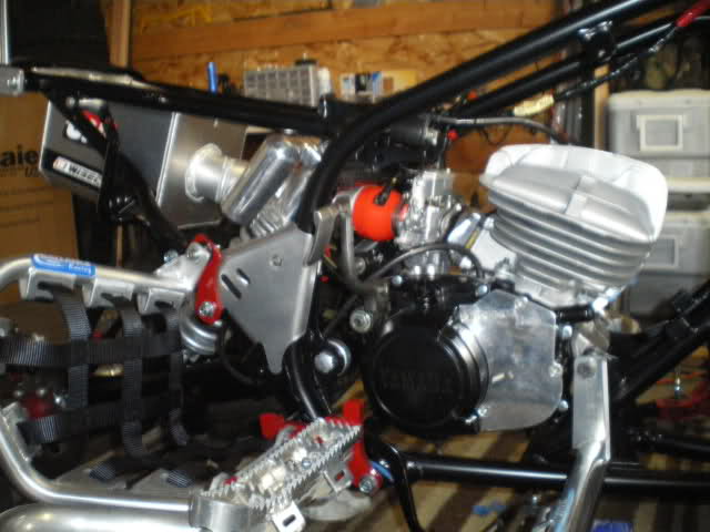

Ok, so I ran into this problem,
http://www.blasterforum.com/engine-13/pro-design-manifold-help-plz-39955/
I ended up finding out the manifolds were made for VF2's so did not matter that I already had modded. So this was what I ended up with after porting inner cage and manifold.
So here is the inner VF3 cage after mod and port
Billet Pro-design manifold ported to match inner VF3 cage
Pic of both ready to mount
Mounted on motor in frame with carb and some new stainless

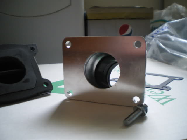

First Pic: Intake reducer suggested by AWK, best 15 bux I've spent on my blaster, it is an immense improvement in taper, quality and seal when compared to the CFM plumbing reducer.
Second Pic: CFM with new reducer and sticker scheme before mounting

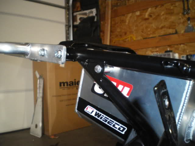

Well................here is some real sh*t. So you remember the swingarm YB gave Ken. It turns out my swingarm shop +3 HD swingarm has the same problem, sits to the side. Since I had not had a chain on I had my axle loosely on it. When going to bolt and adjust everything what was the result....crooked axle, my chain does not match up and after some measuring figured out the whole thing sits an inch to the right if looking from the back. How this was not noticed when I hooked up my shock I do not know, but long story short I'm fukin raging pissed and waiting to hear from these douches in my e-mail. If ever I wish I had some extra cash to just drop on a new one I would, but for now I guess I'll be waiting for them to replace this one.

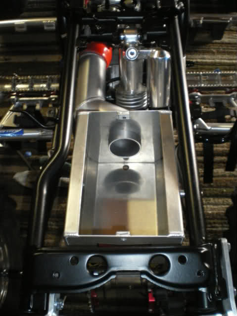

So as explained the holes were off on my CFM as usual, I already plugged and covered them.
Then drilled bolt hole in rear exhaust side gasket.
Cut aluminium spacer (the CFM one was to thick to squeeze between frame rail and bolt through gusset)
Drilled matching mount hole in air-box then mounted this side
With the other side completely secure, I was able to re-drill the hole on this side to mount where intended
It now sits as straight as I could get it with the rear lip of the airbox just a hair lower than the rear sub-frame cross-bar and even between frame rails. I also still have plenty of clearance (1 inch when compressed) between bottom front of box and rear shock It is also rock solid with both sides torqued tight and so I think at this point I won't mess with the wrapped mount I was making.
Better angle of how box sits - man, I have to admit even though I said I'd never sell that billet oil pump cover or polish it I might just clean it up for now and brush the shock, cover, and manifold at a later date

Thank you for posting these pictures of your CFM airbox mounting. That looks PERFECT! I did it the hard way and welded custom brackets which came off the frame rails into the box, and drilled 4 holes in the box! Looking back, drinking 3 Fat tire Ales before doing that was prolly not the best idea I ever had. Yours is perfectly lined up. I drilled 4 and made 4 brackets because I ran the harness for the DT200 harness back there. It had to support the weight of the battery and all the 5 electronic control boxes. Your craftsmanship is TOP NOTCH my man. Possibly one of the best, most thought out builds I've seen on this site or any other for that matter!I:I

Thank you it is extremely appreciated, lots rush but when I decided to do this build it was less about time and more about getting sh*t right so the fact that you notice this makes it worth it........I did not know TM made those and I have been looking at their stator covers.......Yea started making brackets but the gusset provided perfect opportunity for clean mount after looking at it thoroughly. I did however have to re-drill both holes as explained as they were off even for mounting it where intended........thank you againI:I
