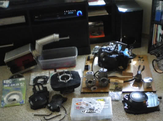

So this is what is going to happen, I have an 06 motor and a 03 motor. The 03 is going to be my ported motor build which I am going to slowly start after I get my quad done and running with the 06 motor. The 06 is not a bad motor either (meaning stock) in the fact that it will have alot of what is pictured.

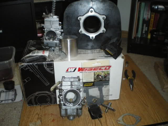

The 34mm TM you see in pic with rebuild kit is going to be sold, I want to buy a new carb for my ported motor. Not that this one is bad, I have full rebuild kit (pictured). I just want a new one. Yes, redundant but oh well. I want my ported motor build to be as nice and new as my quad. I already invested in a pro-design manifold for it so.....
Regardless the TM 28 which is actually listed as vm part number is what I am going to be using for the non-ported build. The cylinder you see was bought off ebay and was an extra but I recently had it de-glazed (cross-hatched) and have a new wiseco-forged piston for it so yea gonna put it together. I had tried to buy 442's hinson clutch for this motor but it got sold out from under me.
hmmm the easiest way to let you know what's what is to list em separate so
1. 06 - non-ported motor which will be running in quad by end of month
Mods: Wiseco Crank, Wiseco forged piston, EBC dirt digger clutch kit and self-modded basket by way of Ken videos. Mikuni TM28, VF3's, stock carb manifold.
2. 03 - ported build (coming) - Already have stock motor for platform, Barnett clutch basket and clutch kit, VF3's, pro-design manifold for TM34 (which I have, but am going to get another new one), and Need: Piston, Stroker Crank (probably Hot-Rods), Port Work, Head Mill, and I think that's it.
Since I already have the CFM/UNI, It will just stay on quad and transfer.
The reason I decided to do it this way was that I want a non-ported reliable motor as backup, since I have gone back and forth over reliability. Oh, and some might wonder why the 03 and not the 06 for ported motor build, and it is simply due to how clean it is. It doesn't need much to just be up and running.

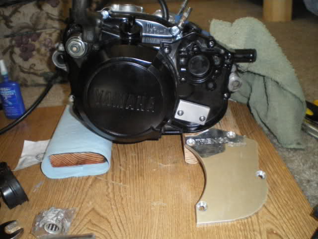

So, As stated this engine was super clean, I built a custom oil block off (super easy, don't buy) as pictured: Oh also put in my clutch and new stainless case bolts (didn't have camera day I did this). If I have to pull it back apart I'll snap a pic.

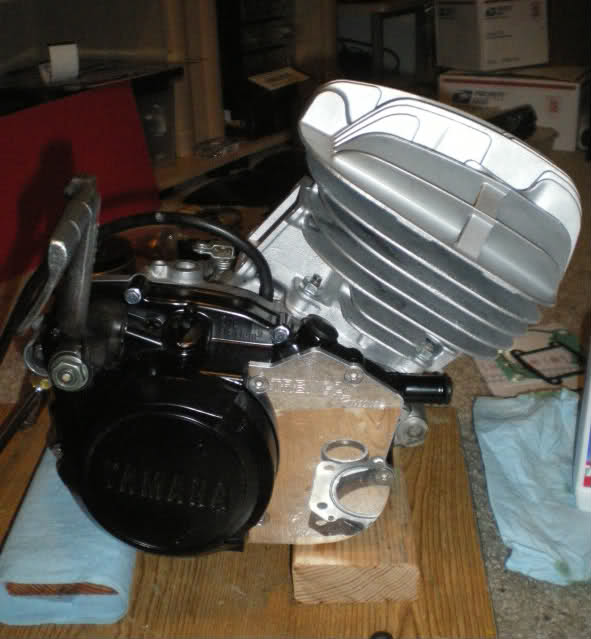

Next, as stated, the whole head was apart, I had a small issue with flash rust but it's all good now: leaving this bare......

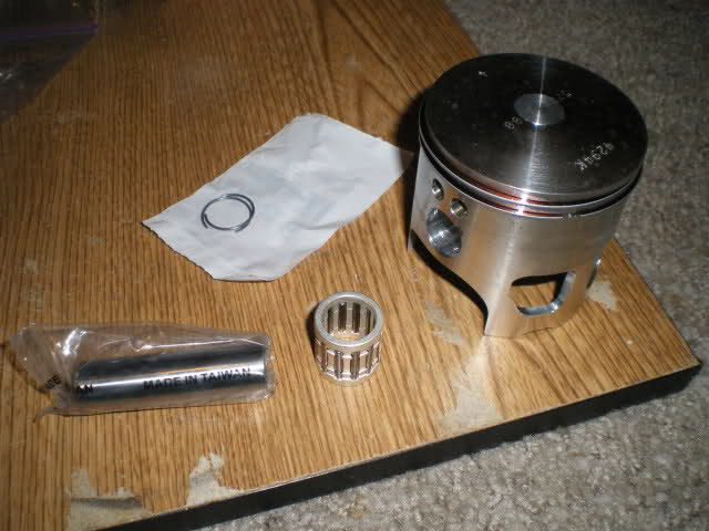

Next all new forged piston kit, using cometic est gaskets, not ones supplied with this kit:
Motor ready for break in......almost: I think for top end break in I will be hooking up stock carb/airbox as it is jetted correctly etc. then after break in, I will switch over manifold, carb, air box and then re-tuning/jetting. Although I have already tuned one of these carbs, I do not want to take chances on jetting while doing break-in.
Man deciding what I'm using for this motor, and how long my ported motor build is going to take is getting hard. The trenga cover which will be switched over is going to have to be brushed I think to match rest. It's hard to keep sh*t polished as my riding area is not nice to polish....lol. I debated long and hard whether to paint this head, but actually think it'll look good like this with my freshly painted flat-black exhaust coming out of it. Since this motor will only be on this riding season, I decided the bare head would not be a big issue.
