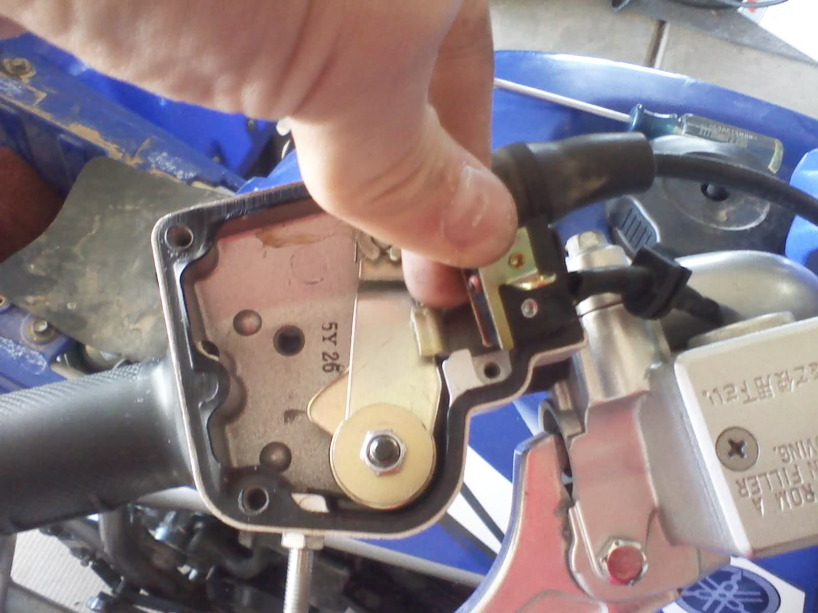

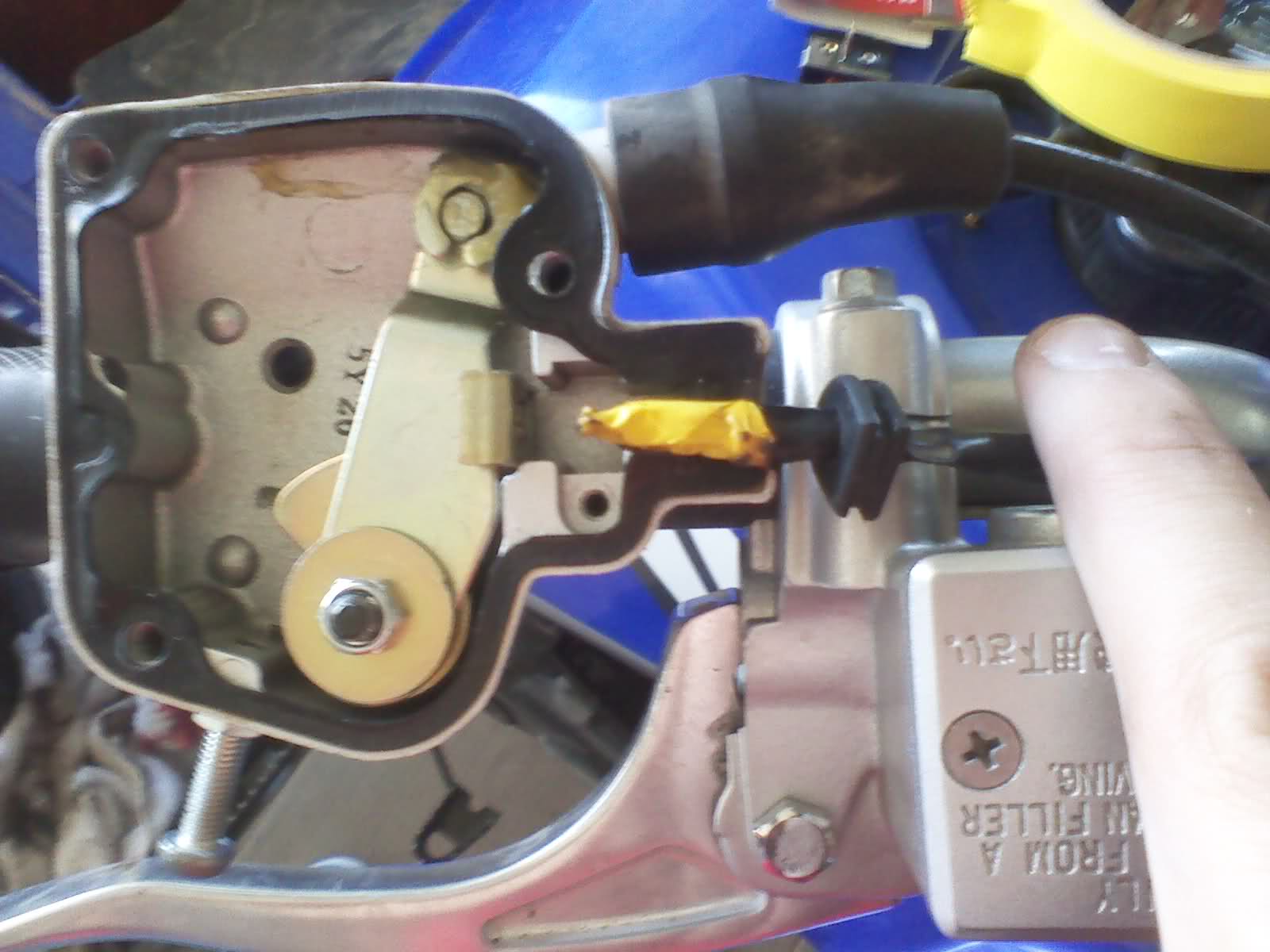

well i had a few spare minutes to kill today and my blasty runs still kinda crapy so i figgured out my issue was due to the TORS, and yes it was, i documented with pictures for everyone.
i just did a simple wire cut/splice and unplug, i plan on getting a pre +03 blaster cdi that has the TORS unit separate so i can clean up the look and get rid of the wires from the tors. I noticed she runs real crisp and revs crisp like one of my 125s. 5min well spent

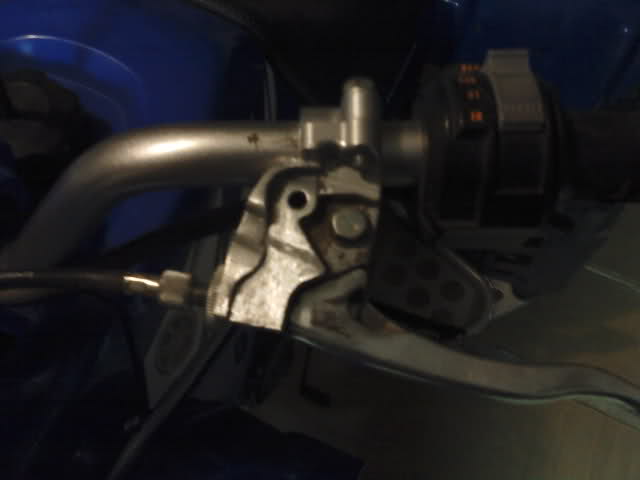

still waiting on some other parts, i was short on time but i was dying to do some work so i eliminated the parking brake.
Instead of throwing on a cheap dirt bike clutch perch n lever i modded the OEM perch so none of the parking brake assembly was left, I planned on doing some ASVs once i get the big parts of my build finished. Im too lazy to polish like 442 does haha

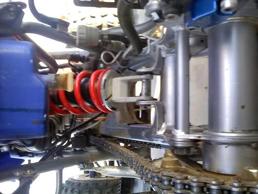

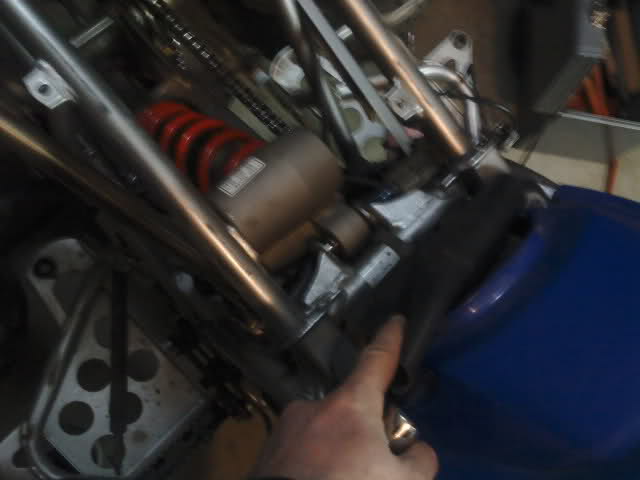

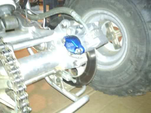

here is some pictures on what i did over the holiday. unfortunetly some stuff didnt come in due to the holiday so my work was limited.
Thanks to AWK's guiding words i got my trx450r shock on... its smooth like butter, it actually lowered my back end by about half an inch which i like.

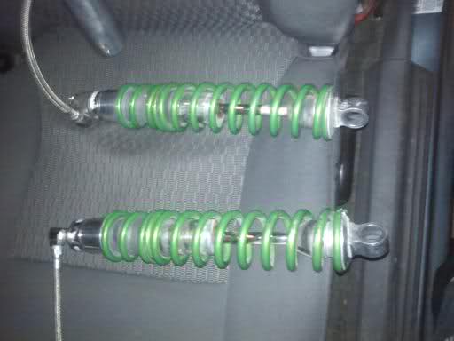

My works shocks came in but ran out of time to install them :(

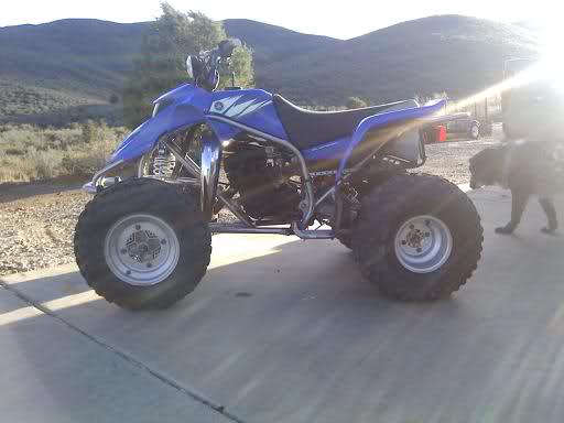

welp this is what i accomplished on my weekend. hope u like. i entered it in BOTM vote it if u like. i dont plan to win just wanted to promote the competition. she is farrrrr from done dont worry
