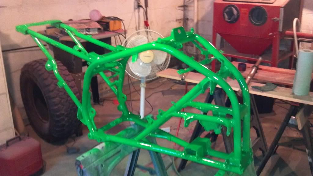

my daughter's blaster build
this was the color i was originally going with but my daughter changed her mind when we started looking at powder colors. i was also going to mod the pre '03 frame to accept disc brakes but changed my mind when i found the '03 and was able to get it for $700
this frame is also in my basement collecting dust as well as another thats un painted

Stunning job on the powder coating!!! Like a previos poster said you should start a thread on how to powder coat in your own garage.
