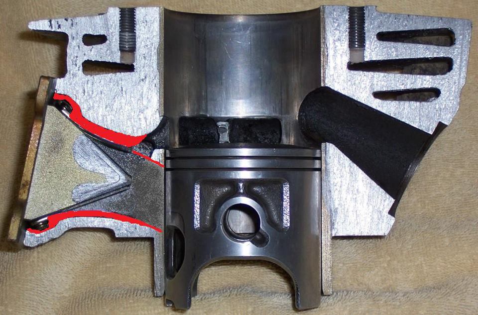

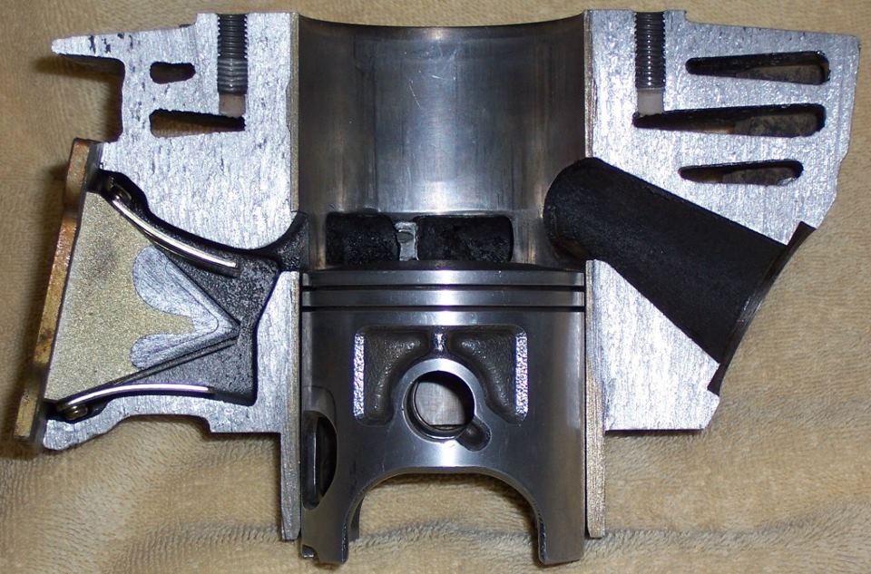

Triplecrown's butt dyno couldn't really feel a significant advantage with this one.
We actually felt a huge difference filling up that area with epoxy:
(thanks to JoeAK47 for this cutaway photo!)
Added epoxy:
Steve
A spacer there will only tend to make the power available come on at a slightly higher rev.
Wether it increases top rev torque is debatable.
a reed spacer placed between the intake and reeds or between the reeds and head will either move the torque up or down the curve. no real bonus power. just Moving it. at least thats how it worked for me.
