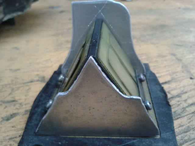

Hey, before you hog out your intake, you might want to have a look at this opposing view.
Filling in the intake improved the power EVERYWHERE.
The port windows were opened up about 1mm but most of the port was filled in with about 2.5 oz of JBweld and epoxy putty.
This did not constrict the port, but made the port as much as 6mm (1/4") deeper and closer to the reeds.
1/8" aluminum plates were epoxied on both sides of the reed cage too, to take up volume and raise crankcase compression.
Think about this, your carb is only 26mm or about 531mmsq.
Your boost port is 20x8 and your intake ports are 19x20 so even allowing for corner radii your port area is already over 800mmsq.
Why would you want to make your ports 50% larger than your carb can flow?
Your airflow velocity drops off and your fuel drops out of suspension, dribbles to the bottom of the case.

By reducing the intake ports to the same area as the port windows and lengthening them and stuffing the reed box
you have kept the velocity up, increased the momentum effect and increased crankcase pressure.
When that piston window opens up you have a battering ram of momentum to ram the mixture through.

Yea...about that...i dont know id trust jb weld on anything like that.The last thing you want is that garbage chunking off into peices in the engine.And the aluminum side peices on the reeds look scary.

NO, the JBweld or aluminum side plates will not fall off if done right.
