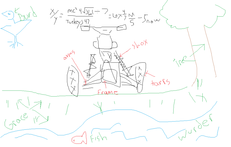

I spent the last 6 hours running the numbers on the geometry in this diagram. If you follow it exactly, it should work flawlessly. This was done using my specialty suspension model software.
