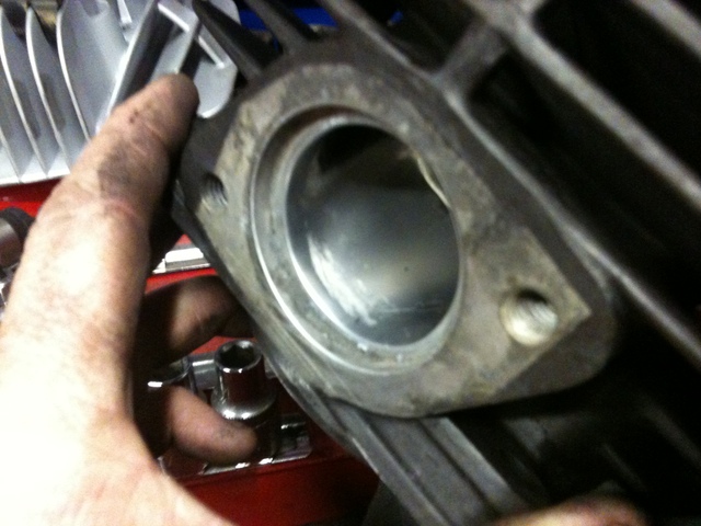

had a go at my 240 cylinder, not perfect but alot smoother than before still waiting for my vitos piston, been 3 weeks now!
few marks in the second pic but didnt want to go much deeper as i was flush with the gasket at this point

I did and the difference was HUGE! I raised the exhaust slightly more than 1mm and widened it just a hare almost accidentally at the bore keeping things smooth. Matched the exhaust to the gasket, cleaned up the transfers, opened up the boost port and removed a LOT of metal from that whole area. Also, I cut the piston a bit to better match. Oh, I also shaved my head down a TON, gave it a nice dome and squish band. However, it was the toomey racing pipe that made the biggest difference I think ;)
I did something very similar with the 1st jug I ported, raised windows, raised exhaust, cleaned transfer ports, cleaned up piston windows & slightly enlarged, also with a Toomey exhaust. Lil engine runs very impressive, working on the 2nd jug for it now, trying to learn more & further refine what I did the 1st time.
