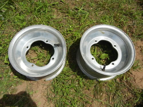

Just scored a set of front ITP YFZ450 Rims for $40 Shipped!

The ITP YFZ front rims came in. I also will be sending Ken the cylinder in 2 days. Then going to Aruba for a week on Friday so wont be much going on with the build then LOL. Next on the list: Drop the frame off at the PC shop.
