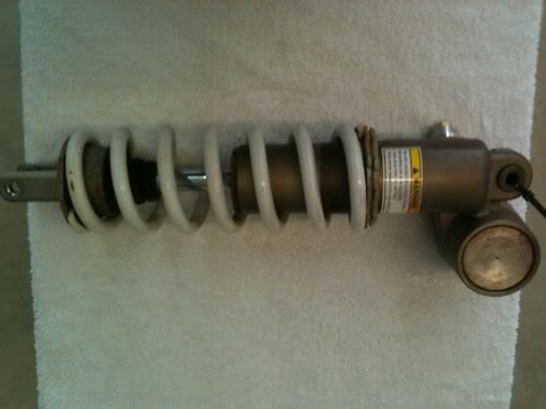

Just won this Suzuki LTR450 rear shock for $13 shipped! Woohoooo!

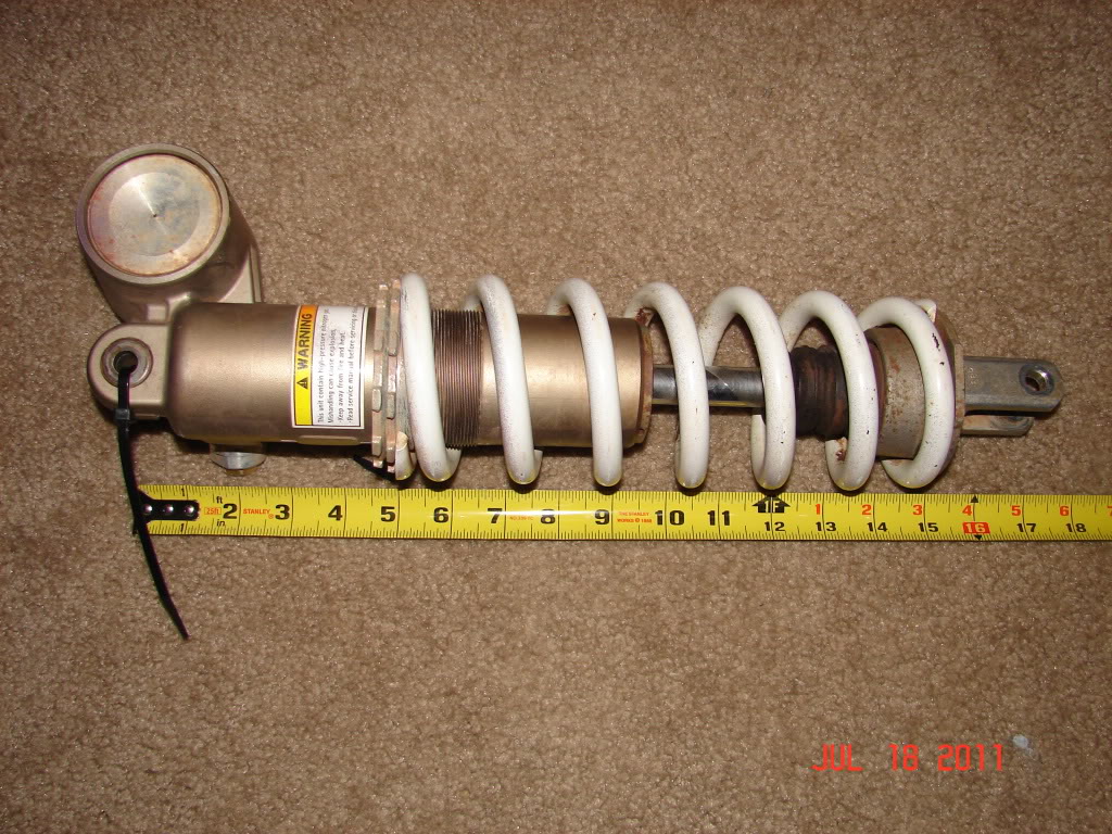

Few goodies came in today. Got the Suzuki LTR450 Rear Shock, Scored it for $13 shipped
Man this sucker is big! Around 16" eye to eye, hope it fits! The preload is all the way loose, gunna have to see what adjustment works for me. I also ordered the 400ex shock bushings and bolt from KOR. Should be here soon

You realy think that shock is gonna work? Stock is like 14 eye to eye. You may have to take the spring out and take a coil or so off to shorten it up
