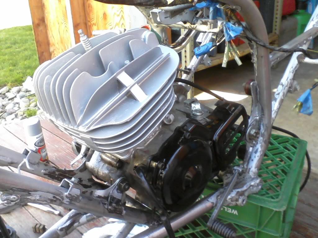

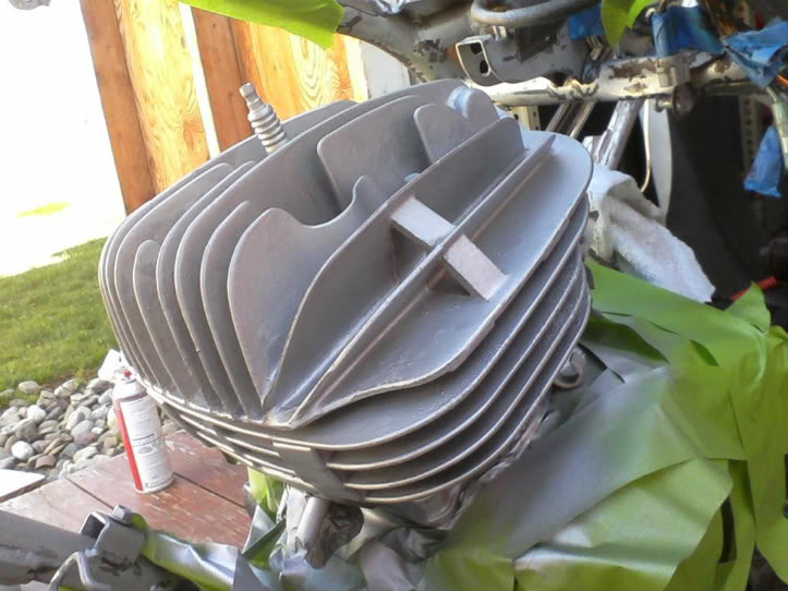

Painted the cylinder today. Used some steel wool, scotch brite pads, 440 sandpaper, and Uni-Solve to get to old sh*t off. Didn't get in between the fins because I couldn't get my fingers in there but nobody will see :D . Used EXTREME TEMPERATURE Silver, first few heat cycles will cure it on there good. Looks great, came out really good. Got some overspray on the frame but I have to sand the frame again anyway. Also, the plug in the head in the pics, its an old one that I cut up at an attempted plug chop. I didn't want any paint inside the cylinder so I just stuck that in there

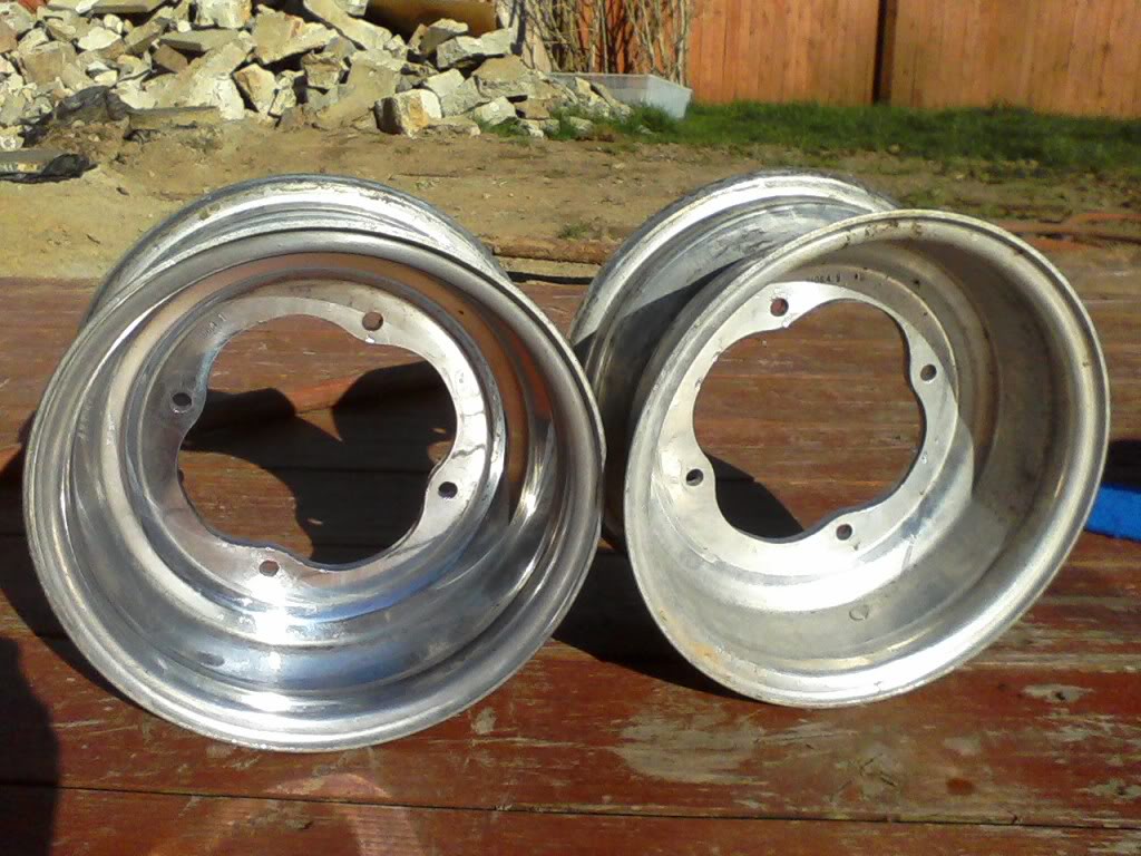

Also started polishing my YFZ rims. Well, one rim actually. Scrubbed one of them clean, then used a polishing attachment for a screw gun, and some "All Metal Polish". Only ran the attachment through the rim for a few minutes, battery on the screw gun died. Can you tell which one I did?
