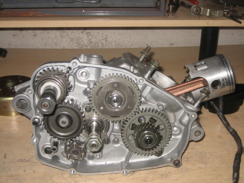

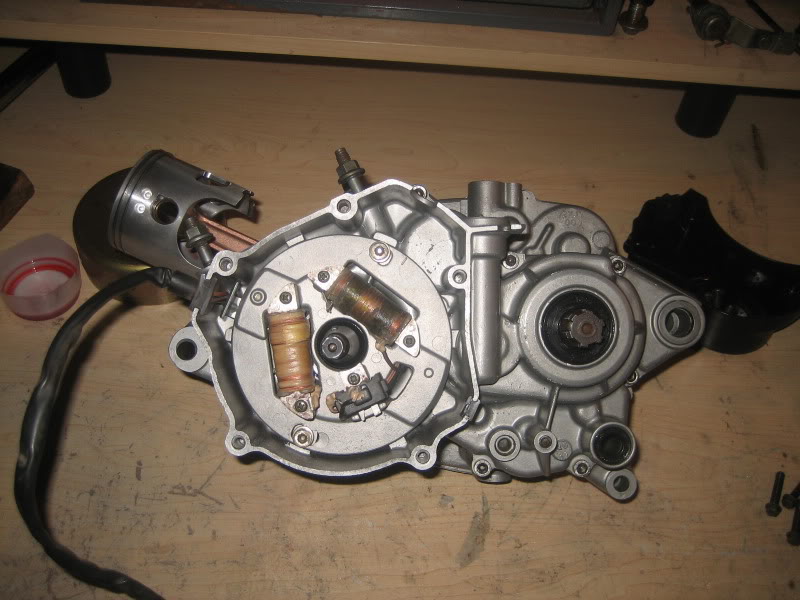

Well I got my crank gears torqued down to 58 ft. lbs. and my balancer gear torqued to 40 ft. lbs. with medium thread locker. Also bent the tab on my balancer washer to ensure the bolt stays put....not like the thread locker won't hold it good enough...

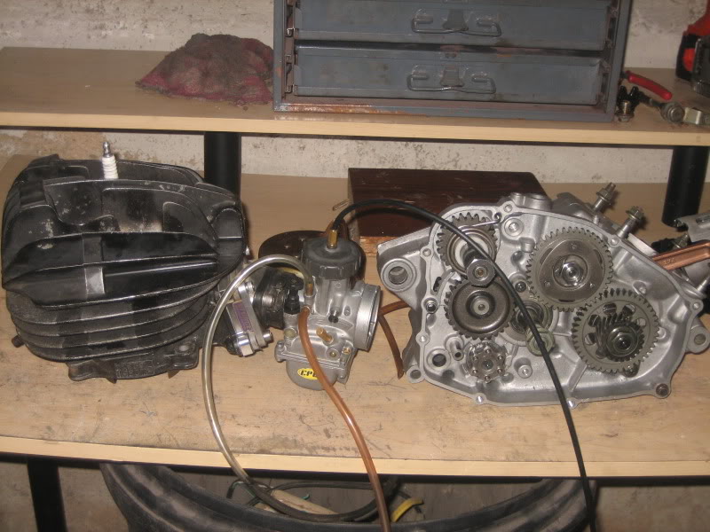

Here's a few pics of the slow progress....guess I'm going slow because I know my sidecase isn't going on til my oven is back up and it is powder coated. I am however going to glass bead blast the jug and head to match the case. Then misc. stuff i will powder coat. So it's gonna be a bit before it all goes back together now. Still hung up on the candy orange transparent with a chrome base, and the smoke color.
Here is the motor so far
With the gears torqued to spec and medium threadlocker
Stator in position and advanced timing

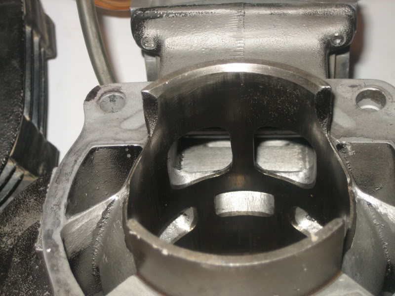

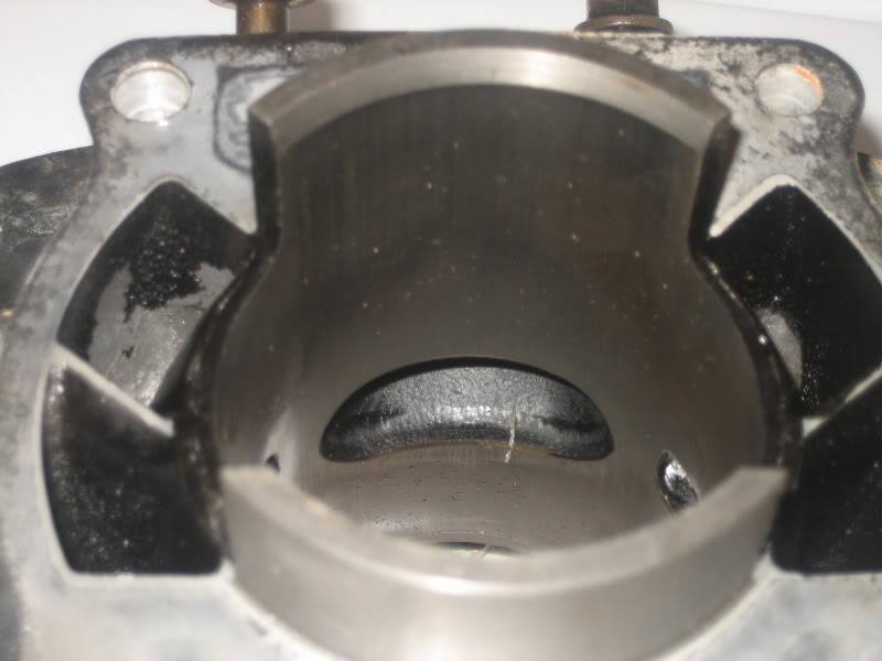

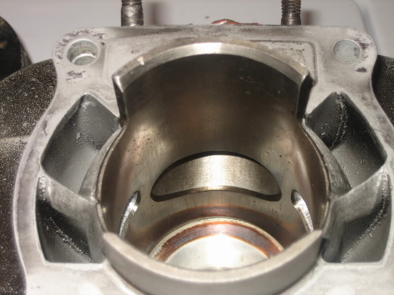

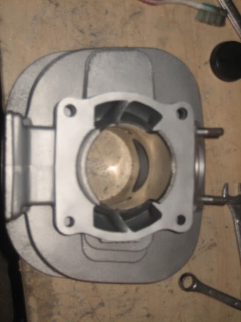

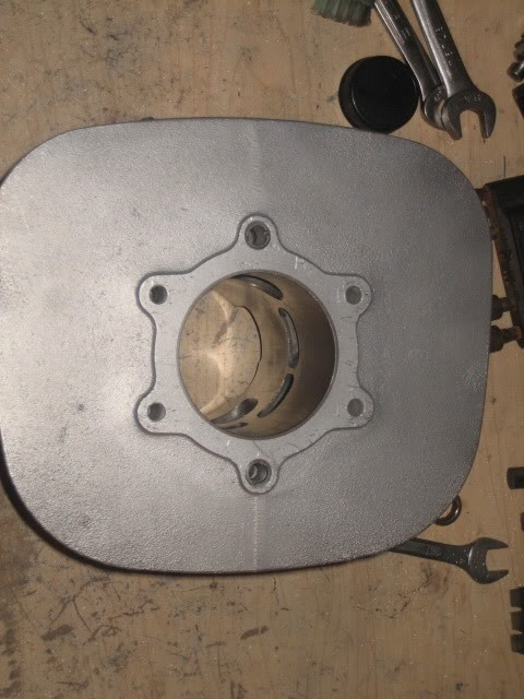

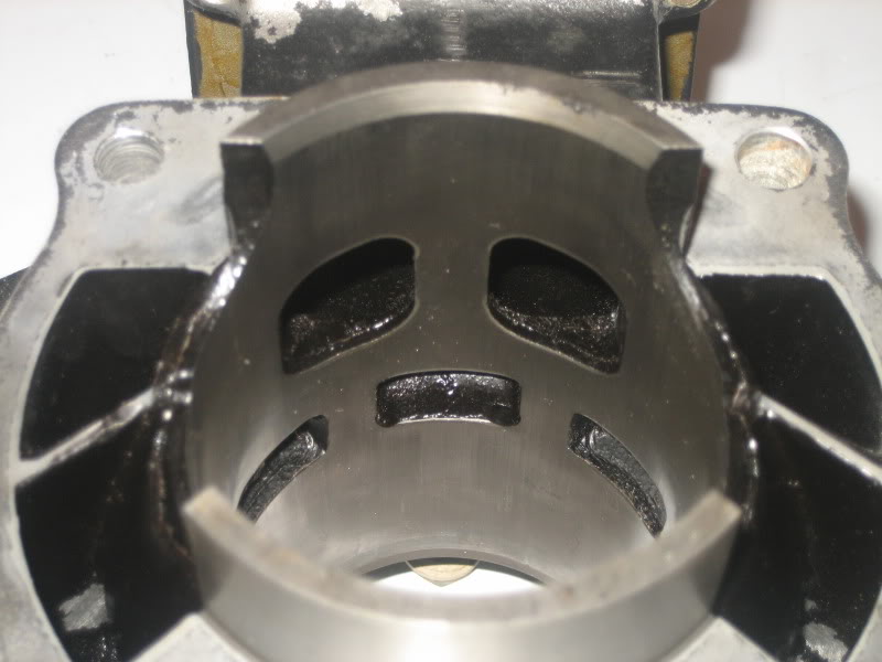

I noted the difference in porting with the stock jug and the Kennedy ported setup i bought from a forum member
Stock
Kennedy
Stock
Kennedy

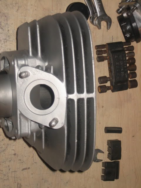

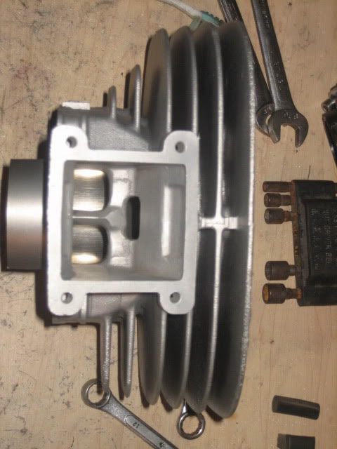

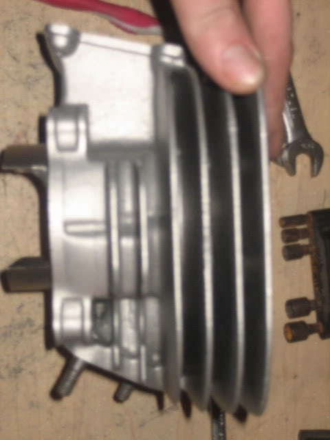

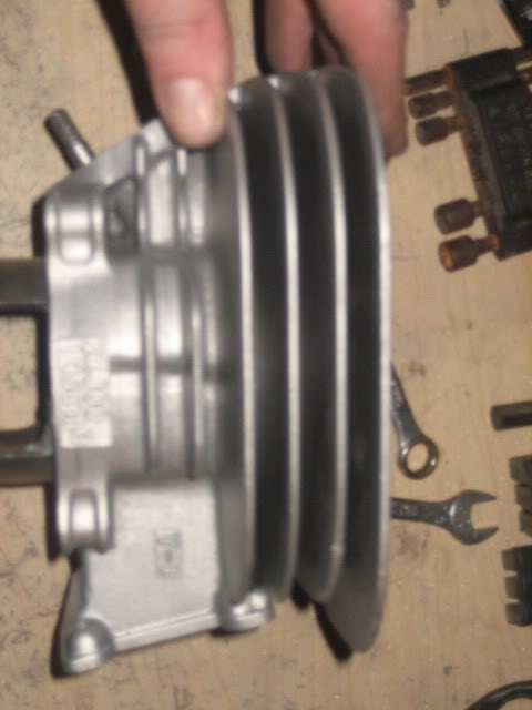

Well I got my jug tore down and glass bead blasted the jug....head is up tomorrow
Got all my studs cleaned up as well and put some meduim threadlock on those as well so they will stay tight
