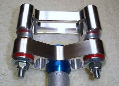

Come to find out, if you do a search on ebay for yamaha handlebar clamp, there are quite a few to choose from and different size bushings for them as well. The RD350, YZ490, XS650, IT490, XS400, XS750, DT250, and TT600 are a few to name that have the rubber bushings/damper for the handlebar clamp. Some with different size bushings so you can fab your mount to that. Cross checked it with Bike Bandit and the bushings are anywhere from $9-$11/EA and some require 2 bushings per side. A little expensive but sure beats having to get a mount with a taper in it. Buy a 1 piece top to the clamp and you're all set! Oh...some require only 1 bushing per side too...I believe the TT600 has one bushing...I'd prefer the 2 bushings tho because they are a little bigger on the tops to sit right into the mount

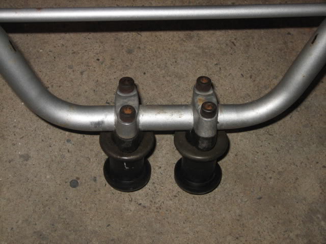

Well I opted for the 78' Yamaha XS400 handlebar clamps. Looks like alot of rubber here so it should offer a substantial amount of dampening! Here's my dilemma...they are almost too big. in order to weld up the tubing for the big rubber dampers, they are going to have to be separated more than what the clamping distance on the Blaster OE handlebars offer. So...I am wondering if there are any bigger 7/8" bars out there I can use to separate them more? Also...I am getting a billet top clamp instead of using the OE stuff...I am wondering if i will also have to use a clamp with a little more distance in between it too? I'll show pics for examples..

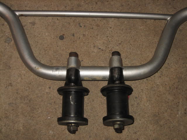

Here is what i am working with now

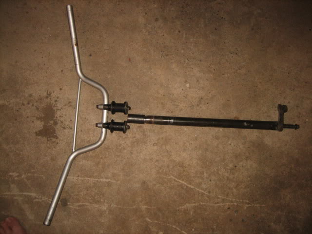

Here is the clamp that they offer (ASR CLAMP)

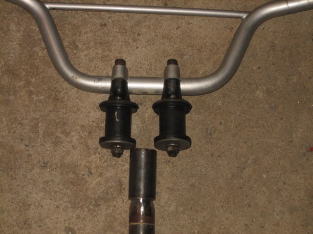

Here is what my spacing dilemma looks like
I'm thinking I'm going to have to make the piece that connects the 2 dampers together, then weld something to extend just past the dampers on the bottom where I can weld it to the steering stem. Maybe have to cut the steering stem down about another inch or so...because this will raise the height even more.
Just need some help on handlebar choice...something that spreads the clamp area out a little more so i can maybe put an inch more space in those rubber dampers!

Shee....I moved the clamps out as far as they would go on the handlebars....well as far as the grooves were in the stock handlebar.
