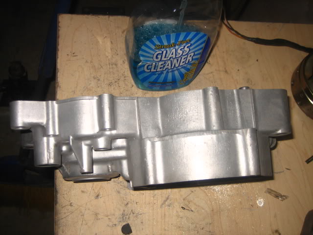

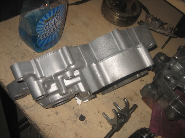

So I got my blast cabinet back up, and decided to try some glass media for shining up the cases a little better. This is a rough cut of one side, but this was one pass at 80PSI and next I will back it down to 40PSI and make it shine up a little more.
Oh...and the bearings will be thoroughly washed out from all glass media and oil ran over them to protect them for the time being
Here is the other sidecase to show you what I was working with
That only took about 15 minutes...next pass will be slower and take about 25 minutes to 30 for the shining up part
I still have some grease spots here and there to dig out as well...but I'll get them done tomorrow and post up better pics. This gives you an idea if you wanna polish the cases to factory new if you want to without the effort of degreasing and using a wheel to get it to look decently clean

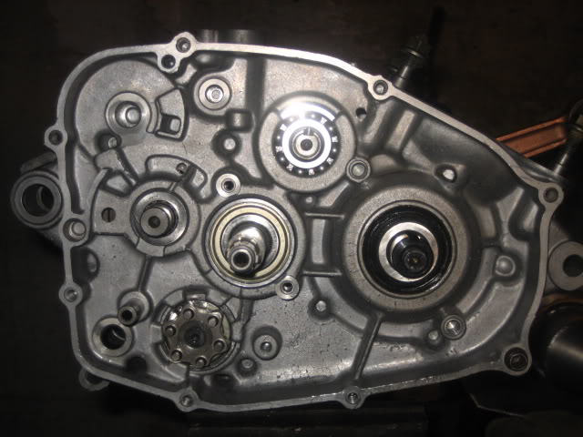

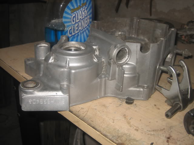

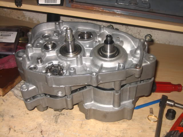

Well I got some progress today....got the cases blasted off again and the factory silver is back

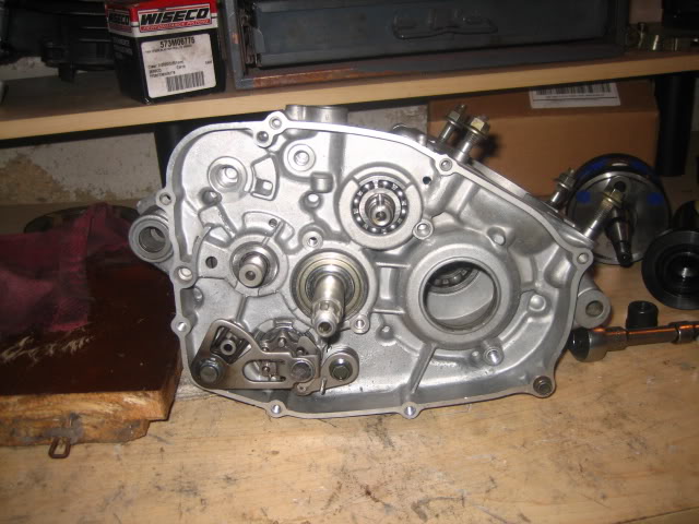

Test fitting the cases

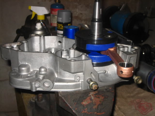

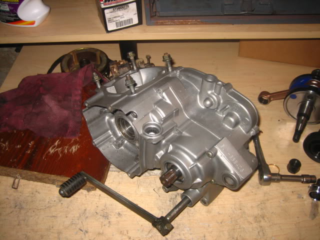

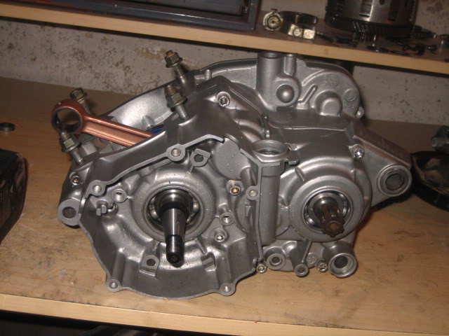

Then i put a very thin film of Yamabond 4 on them and cranked the other side of the case down on the crank. I also tested out my clearance on my stroker crank and it does very well with the rod in the middle of the stroke, and turning it around

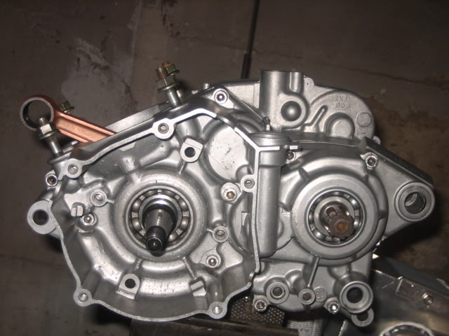

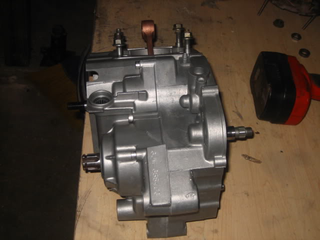

Here they are put together
Oh yeh....before i sealed up the cases and put the crank in there snug, I tested out the gears and see if they shifted correctly

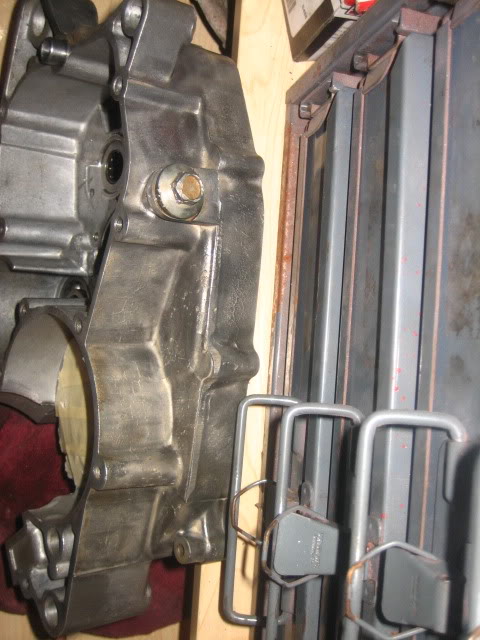

Tomorrow I'm gonna clean up this dirty stator plate
And put the seals in it...and maybe I'll put all the gears and clutch back on tomorrow too. It's time to watch Ghosthunters

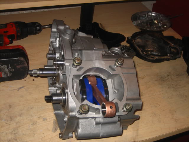

So after extensive reading on this spacer plate for the stroker crank, I'm ditching the spacer plate since it was port matched by Kennedy's before. I noticed it also had 2 gaskets with the Vito's stroker crank. I just use one gasket, correct? See no sense in doubling up on gaskets...
For future reference to check if your transmission is together right just put both shafts in and rotate the shift drum, and it will shift if it is together right, you have to spin the shafts of course.
