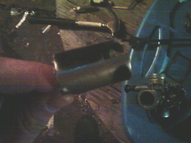

So just became an official supporting memeber. Thought Id show what happened to the carb for the slide to lock up, and maybe blaaster or one of the more knowledgeable guys could explain. Carb was in the guide, expanded out or something. So heres the pic, click on it to see I guess.0121142146.jpg
the black on the slide is normal wear, all of them do it
