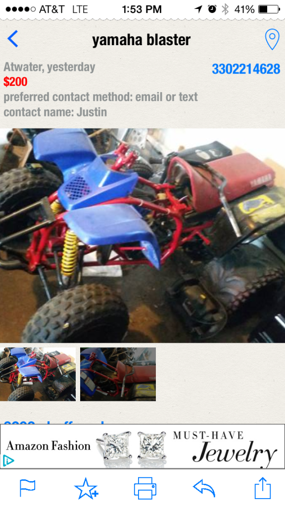

Here is the CL ad, a mis match of everything. Frame paint is terrible, parts missing, lots of work needs to be done

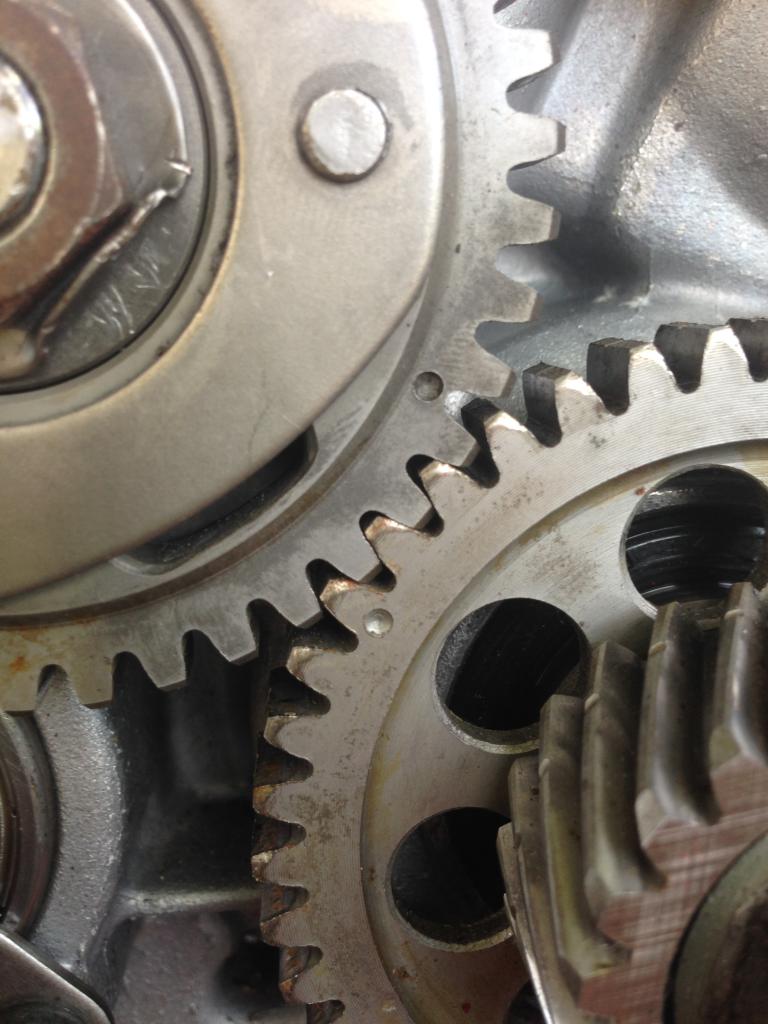

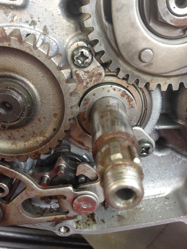

Once home I pulled the Clutch cover off, No baset but saw all of this

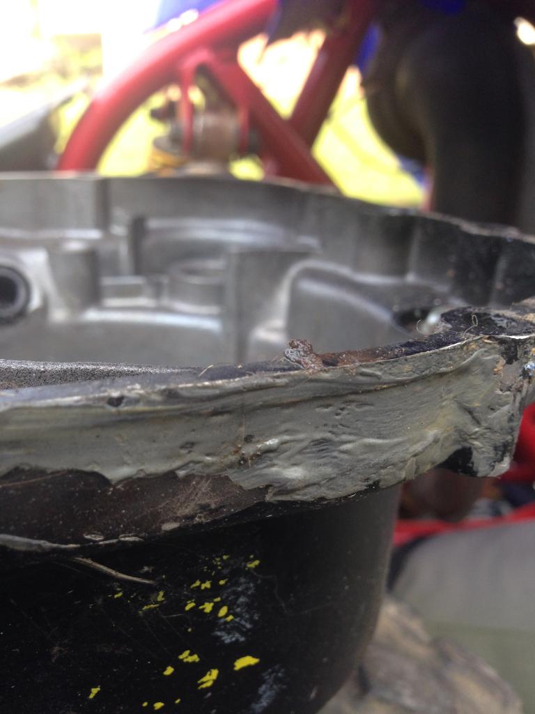

Someone used alot of gasket sealer! Its like that the whole way around the case...

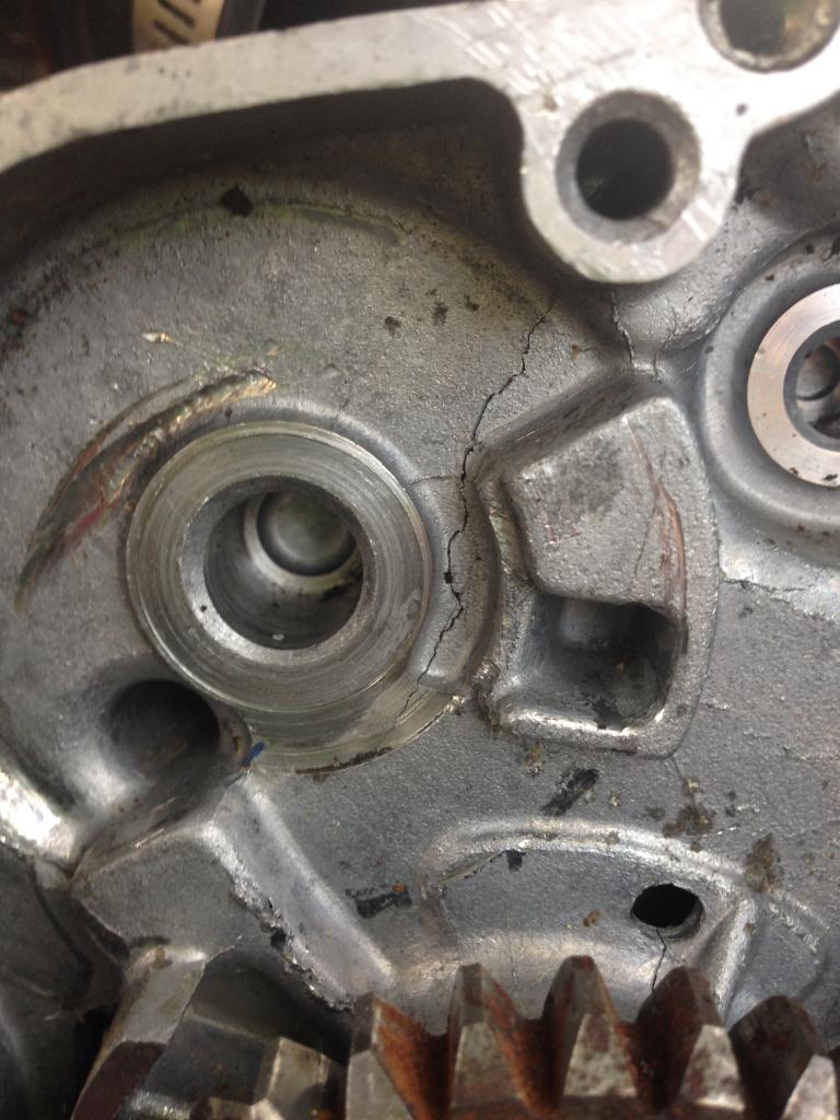

someone must have dropped the motor to crack that case half right there. i have never seen a case cracked in the kick start area before.
Yeah I am worried about that case being cracked up there. I didnt look on the back side to see if it went all the way through. Was just doing a parts list and whew... this thing is going to need lots of $$$$ put into it just to get it running!

-Right Case Half if that crack is bad enough $50
