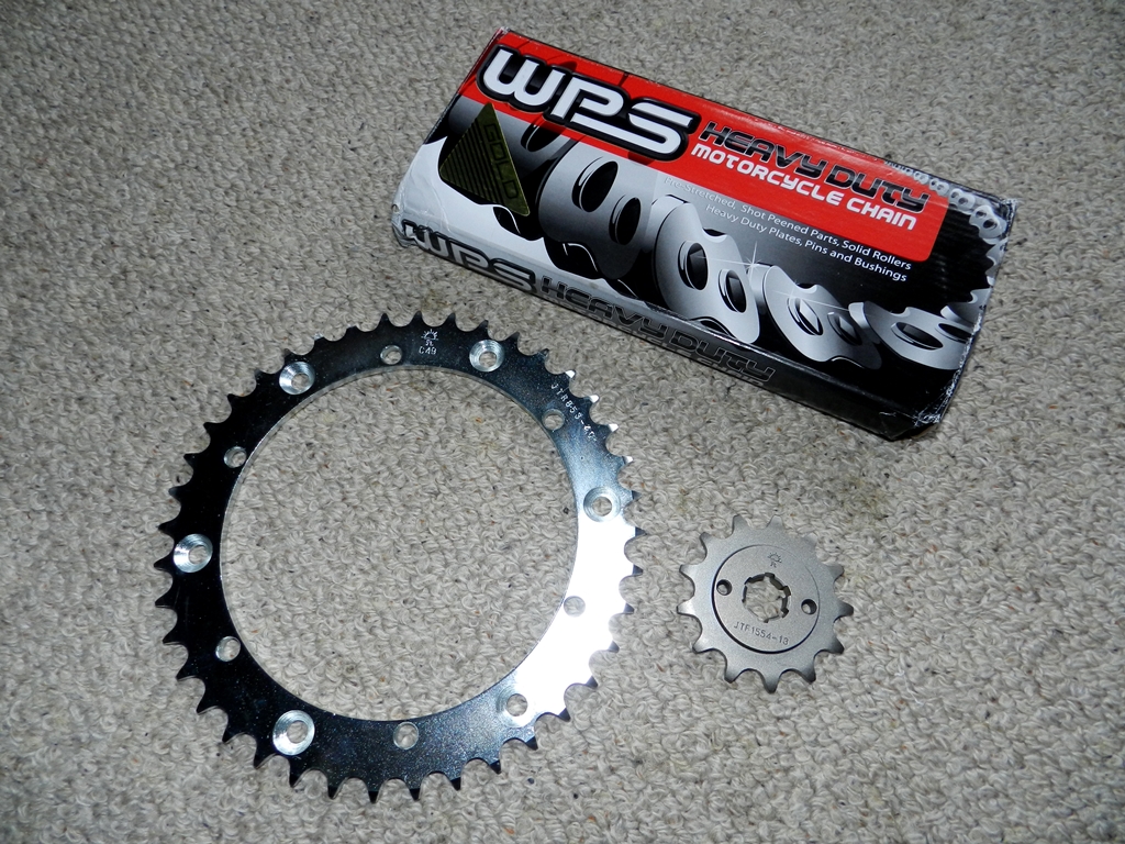

Despite the thread, i believe renthal to be the best. When it comes to an important component as the chain, don't cheap out and buy the $30 off eBay or amazon. Also, replace both sprockets at the same time to make sure the components wear evenly.
I really like Tsubaki chains myself, and unless I was racing will only run "O" ring type now.
