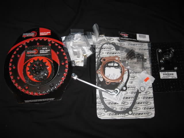

Well, Ordered a bunch of stuff.
Primary Drive 14t front sprocket
Primary Drive 40t rear sprocket
Primary Drive 520 106 link O-ring chain
Cometic gasket set
Tusk shifter
Tusk HD clutch springs
Bunch of main jets and a few pilots
UPP 34mm Intake manifold
Should all be here next week.

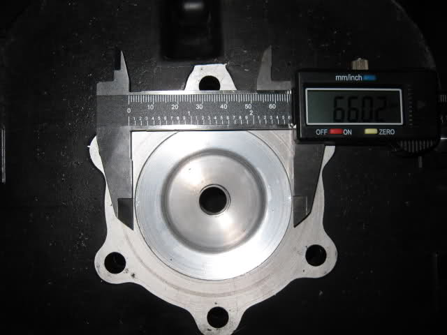

This can't be right for a 67mm piston.
Noticed when turning the motor over by hand it had a lot of resistance at the top of the stroke. Didn't do that with the head off. So I took it off and measured it.
So now the head has to go back to Ken. Won't be riding next weekend like I hoped.

That right there is one reason when I spent all the time to hand cut my squish, I cut it large enough for the next oversize than what I already had. That way if I got in a pinch, I could rebore quickly and put it right back together.....

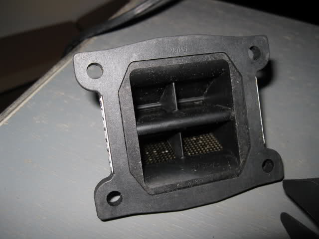

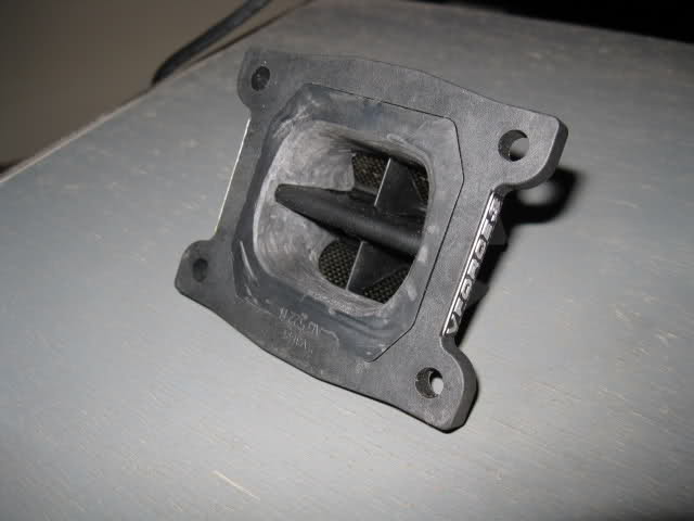

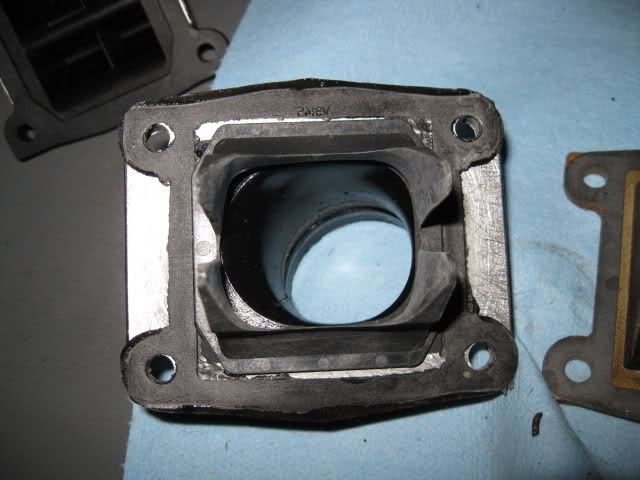

Promised somebody that I would post pics of the porting I did to my VF3's.
After looking at the pics I think I can open it up a bit more and do more sanding to smooth the surfaces a bit.

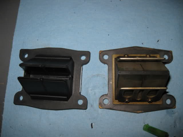

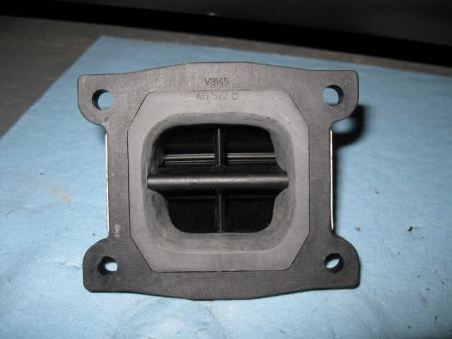

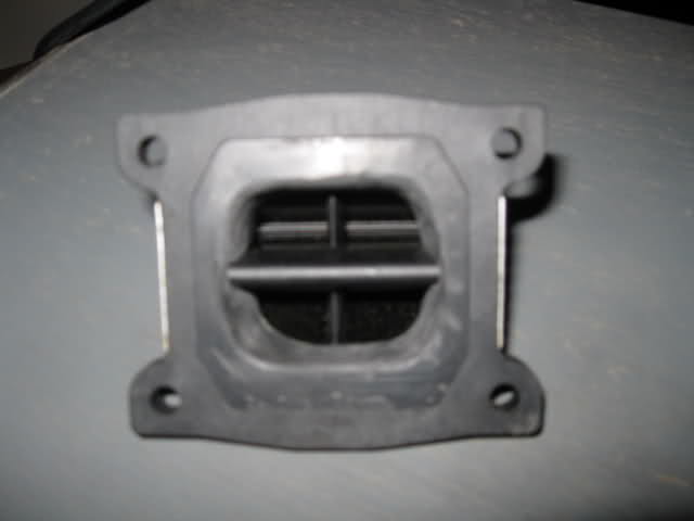

And I worked some more on my VF3's. Looking at them side by side with a stock cage I can see what sicivicdude is getting at.
now show us the opening on the motor side of the intake to compare it's opening to the stock cage and vf3's, it can only flow as much as the smallest opening in the intake tract, which will be the intake or carb ????
