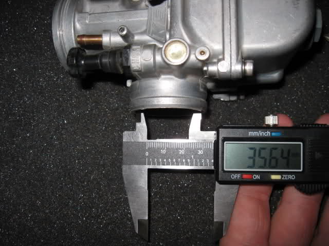

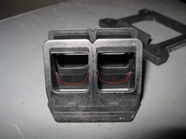

Well with a 35mm carb on it and manifold to match, that big bullet shaped "blob" running horizontally down the middle of the VF3 reeds may actually be more obstruction than the carb throat...

I'm thinking maybe something like this? (awesome laptop touchpad paint skills here)
Ok, did some quick dremel work.
Be careful with that dremel. I'm not sure how much of that frame area is needed to clamp the petals down. You don't want to be increasing flow by blowing holes through that plastic frame.... easy to take away tough to add back!

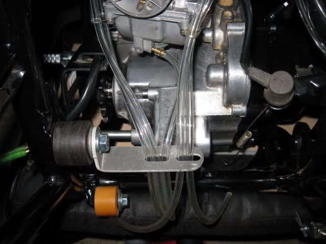

Awesome idea I stole from freak. Was going to make a aluminium piece to hold the vent lines from my carb, then I saw this aluminium bracket from who knows what and the vent lines fit perfectly. Bolted it up and worked out great. There's even room for the clutch vent line.
Thats good i wanted to make one like freeks also but not so big i may make one like that if you dont mind?
Those are just some stock ones. Once those wear out (it doesn't take long) I am getting some bearing rollers. Link vvvvvv
CHAIN ROLLER YFZ450 RAPTOR 700 YFM700 YTZ 250 R34mm | eBay
With those you drill out the threading from the stock bracket and run a bolt and nut through the roller and bracket. Those last a long time. They have some without dust covers and the ones with covers come in different colors. They don't cost much more than the crappy stock ones.
