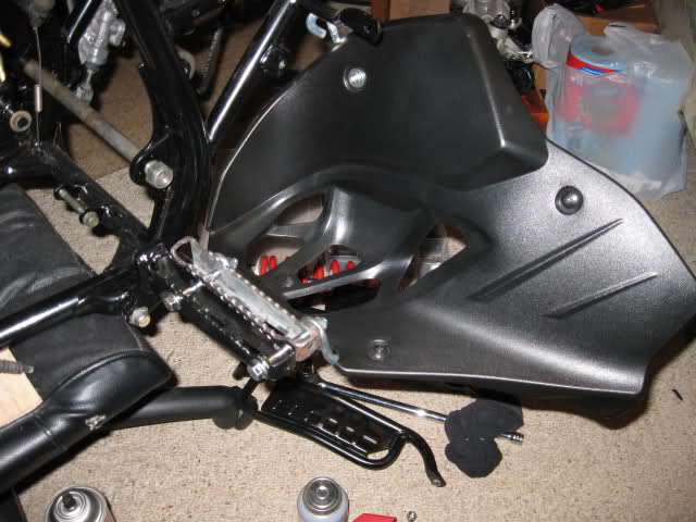

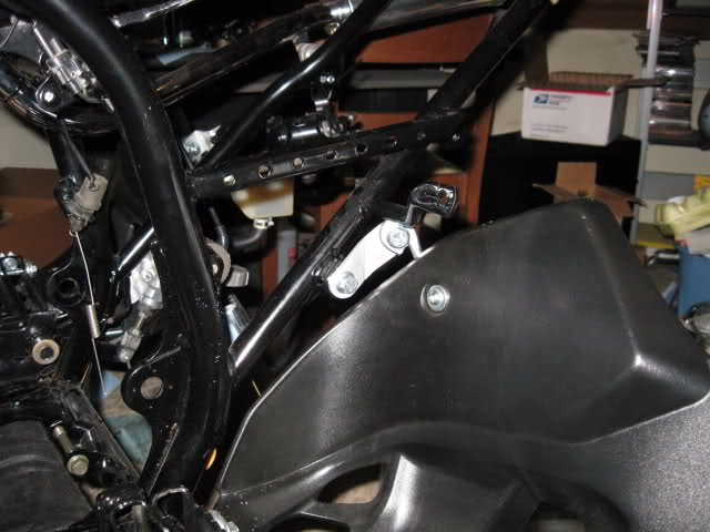

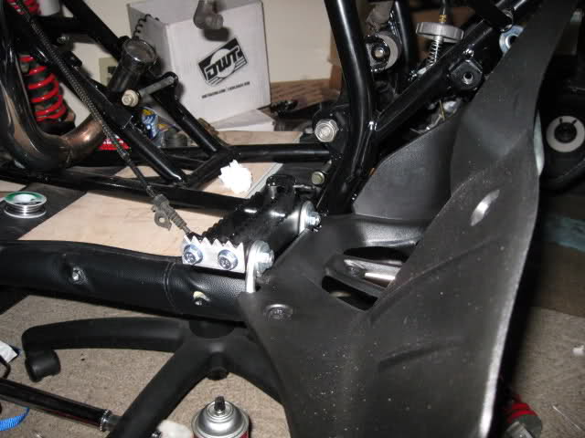

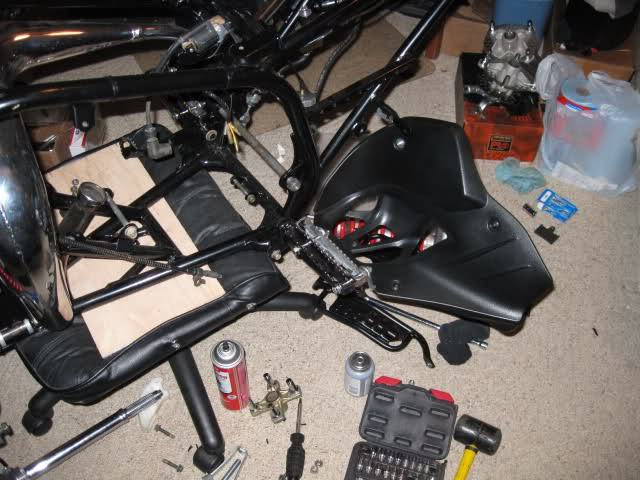

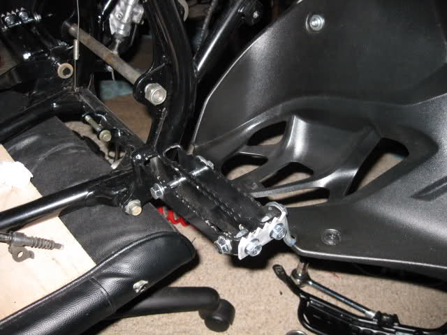

Working on fitting my 450 heel guards. Got a steal on these. 2011 YFZ450R heel guards for $30 shipped. I'm kinda hesitant to do any cutting till I get my other set of pegs to do double's and get my nerf bars.

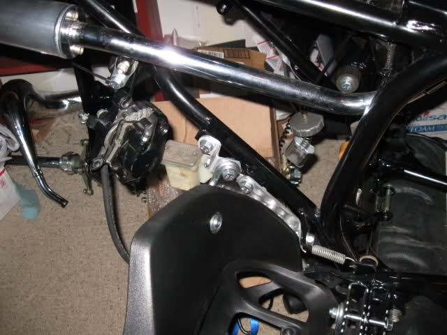

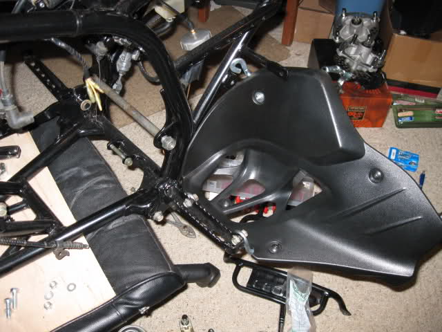

when your looking for banshee brakes dont throw out looking for some yfz 450 master cylinder and calipers too, they are a dual piston caliper unlike the banshees and sometimes they can be had just as cheap as banshee calipers and they will bolt straight up to norms spindles. the master cylinder will work on all of em. good list so far tho. good luck with the build

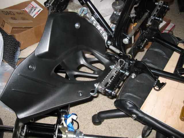

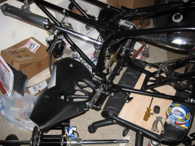

LOoks like im the only one watching this thread?? how did you make those kick ups? the tooth looks very symmetrical.
LOL doesnt look like my sh*tty bar clamps came into good use. Whatever though. Im really liking this build. Keep up with the good work man!
They're in there. Look closer. I:I
Hmmmm.... are they the ones flipped upside down for your mod?
Yep.
