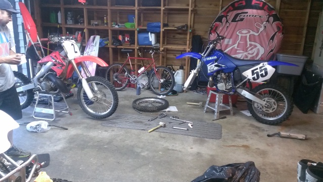

I thought York said he'd port it for the price of shipping. I'm trying to get that top end swapped before my next dunes trip but I have this to deal with when I get home among many other things:![]()
yea he did, not sure if i want it ported though, i just want a reliable bike for riding the naches in 2 weeks, btw what are you doing to those bikes?
