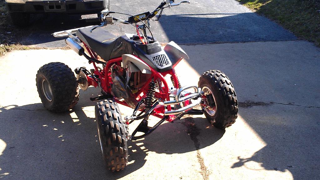

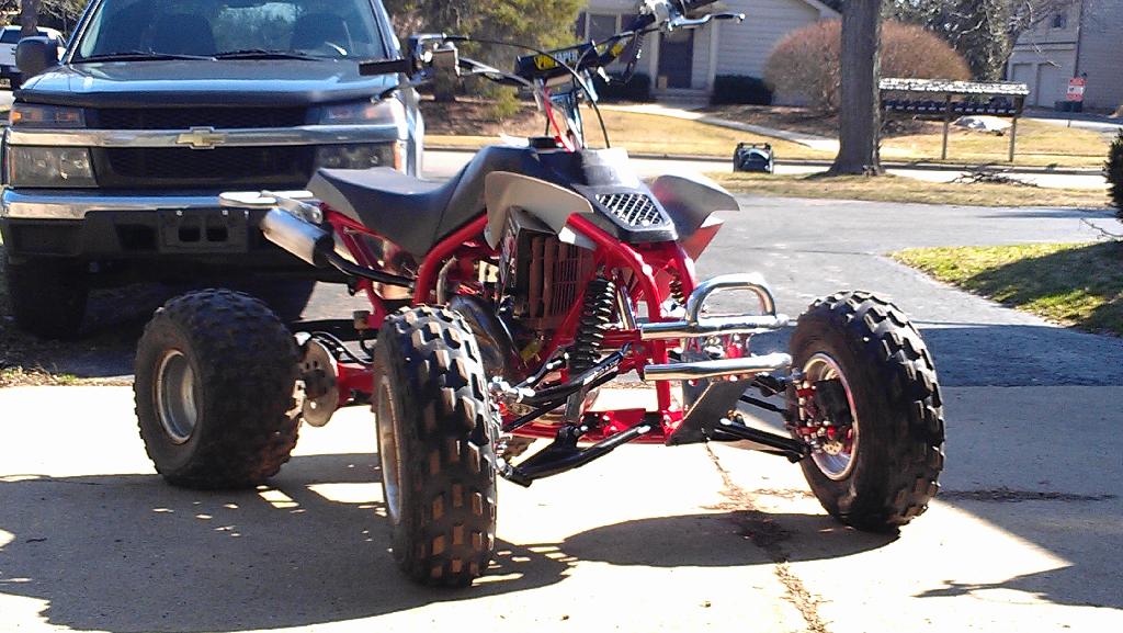

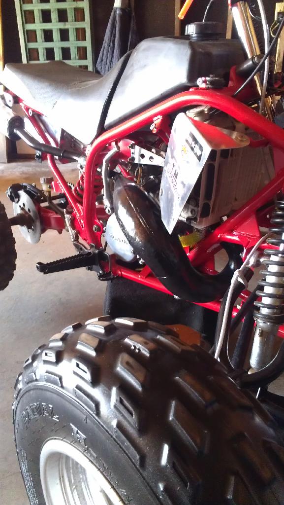

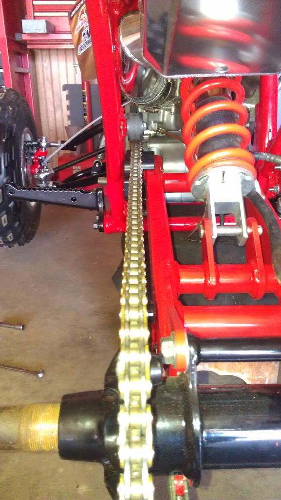

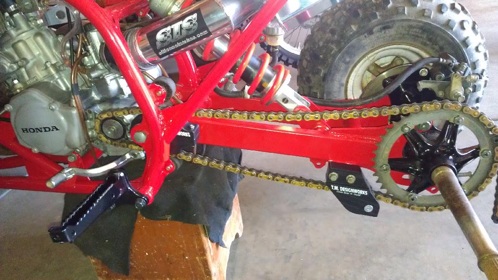

selfies aside...lol just wanted to introduce myself..lol glad you all like the project. it is coming along slowly.

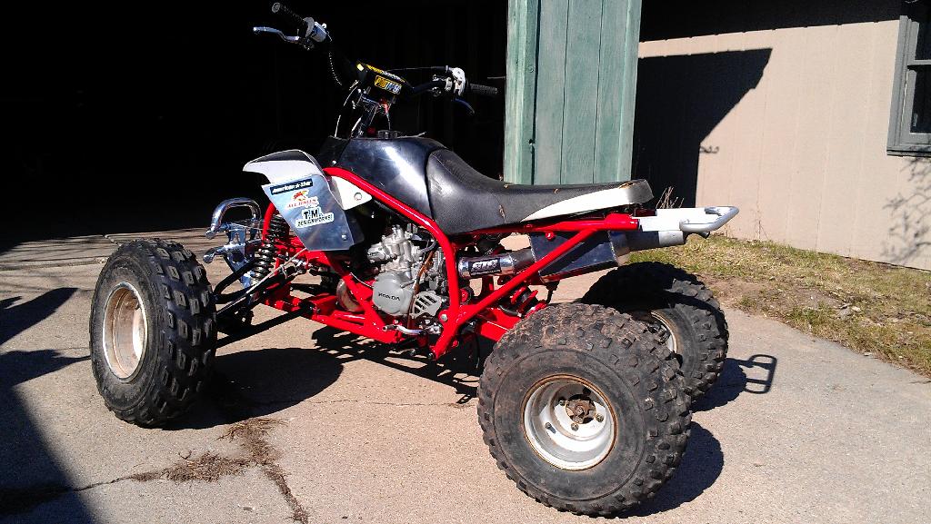

well, got the blaster running pretty good. found i didnt tighten the carb boot to carb clamp. got that done and she tan even better. but, and i mean but, i need to pull the top end. im getting coolant out the exhaust. its not burning coolant, its running out a small hole in the pipe behind the muffler. may have a blown gasket .

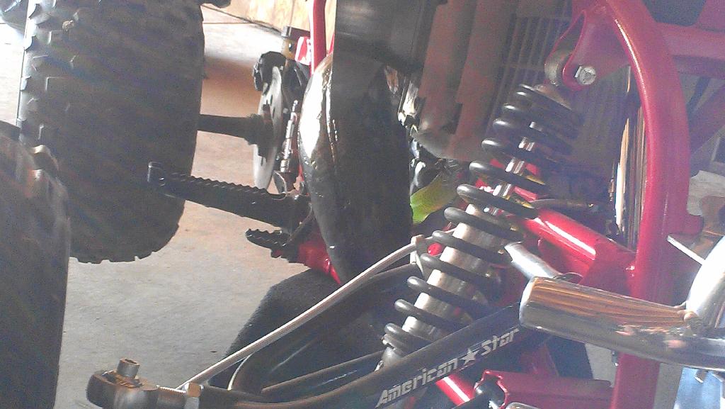

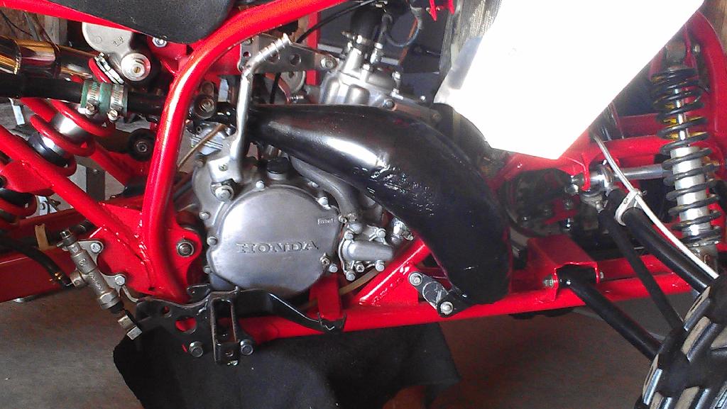

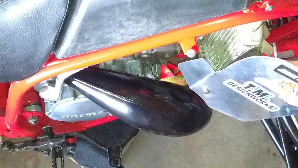

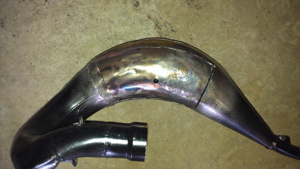

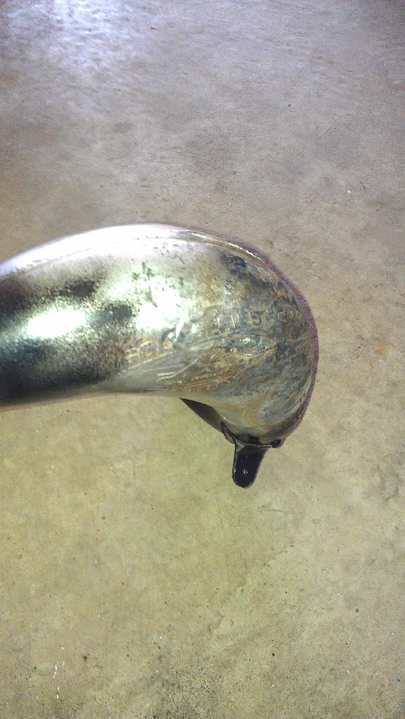

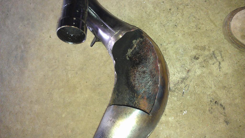

making some progress the last couple days. did some major surgery to my pipe. just need to stich it back up.
it isn't perfect in any way, shape or form, but the dent is out. I have to weld the back back on and weld up a couple spots where it split due to the crease from the dent. all in all, once its welded, dressed and painted, it will look decent.
