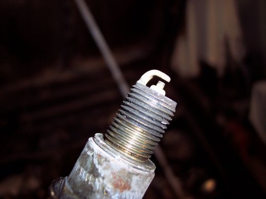

No problem to tell if you need one. Look at the insulator and threads after a long hard WOT run.
Is it white and blistered? Are the last 4 threads blue?
If it is, you need a B9ES colder plug.
If you run a colder plug on an engine that doesn't need one you are losing power.

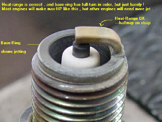

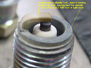

Pictures of cold, normal plugs and hot plugs to compare:
(Hope this shows up with your formatting)

Actually plug temp will show up on a well worn plug if run long and hard enough.
Just that you better make sure WOT mixture is right before giving it a long hard run.
Otherwise it might blow up during the run.
So like the motto says, on a new plug, "leak test - plug chop" for WOT main jetting.
Then when the jetting is right (the ring down near base of the insulator where it is hard to see), do the long hard.
Your day-to-day plug it will normally show cold because of all the part throttle.
Need the long hard run to get it to its hottest.
