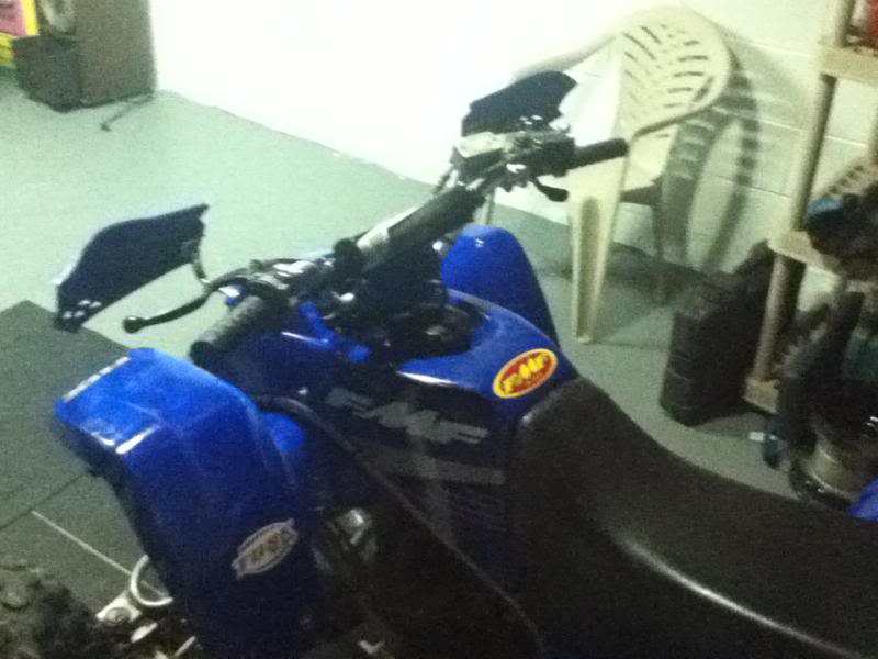

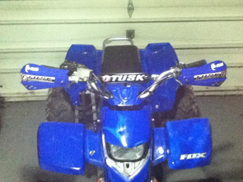

Lookin good!I:I And yes I would DEFINATLY recommend a Re-chambered hemi head, Its a pretty big Improvement over the poorly designed, stock configuration head. Very noticable increase in power. I've also heard good things about the torodial style heads too. You can get a hemi head done by ken o conner for about 70 bucks.

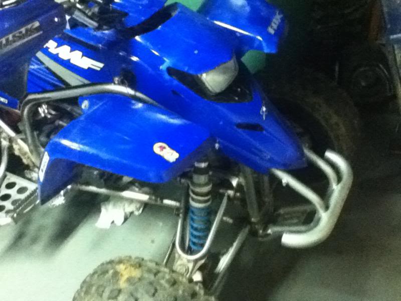

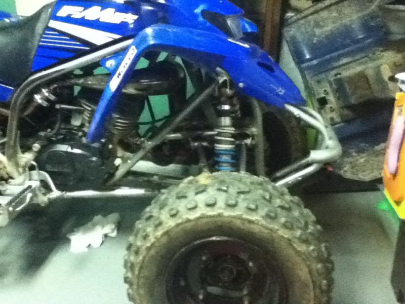

New to me works shocks :)
Next month Im ordering +3 +1 a-arms, 400ex shock w/KOR Bushings, and an Extended swinger. My wife went back to work, So I finally have some extra cash for some things I want. February's Project is going to be a .308 Winchester Build. I need a little more power than my 22-250 for my long range gun.
Be careful on the extended swingarm if you plan on doing a lot of motor mods. I wouldn't go over +3. I had a +4 and it did nothing but spin.
I have ran a +2 and a +4. Felt +2 wasn't enough and +4 spun to much. The blastersaurus has a +3 and I think it will be perfect. I am ordering a -1 for my banshee tomorrow, spins to much with stock length.
