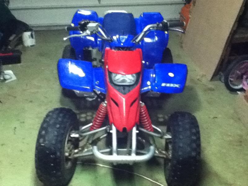

I ordered some wheel spacers tonight. +4's I also have put a blue hood on it. The transformers theme is now dead. I also finished painting my wheels this weekend. I went with a gloss black. I'll put a few pics up later on in the week once I get the spacers installed.

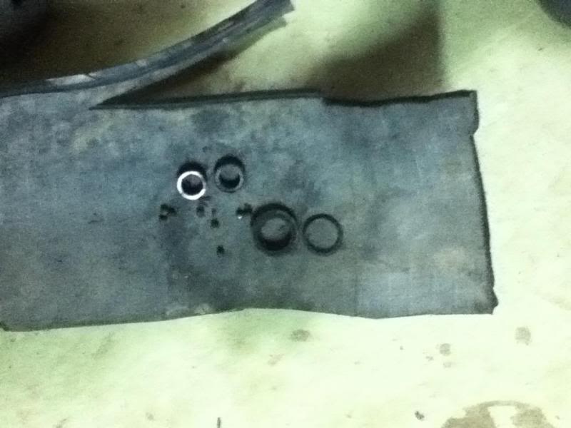

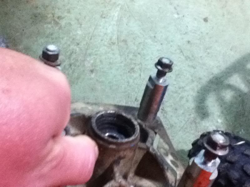

Been riding pretty hard the last 2 weeks, I noticed Over the weekend Some front end slop. As suspected, I need wheel bearings. I ordered all balls complete front kit. My question is should I pop the seals on them and pack them like a truck wheel bearing? They should be here Thursday or friday. Thanks!
I always pick the seal and repack new bearings with red waterproof grease.
There's so little in them, its' a wonder they last at all.
do it !
I have some Lucas Red and tacky waterproof grease Ill use. We use it on Pump Bearings at work, That stuff holds up really well. Those pumps run 15+ hours a day, everyday and are pumping Water. We only change bearings in them every 2 years or so.

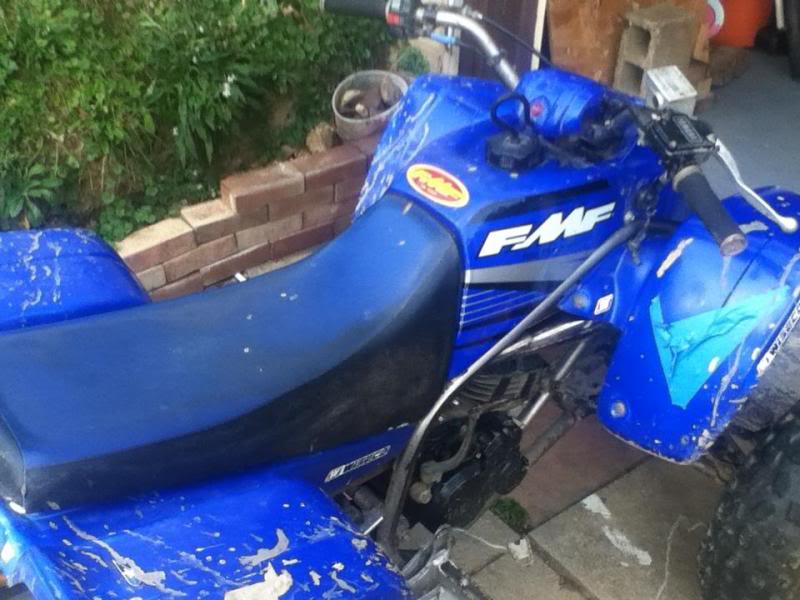

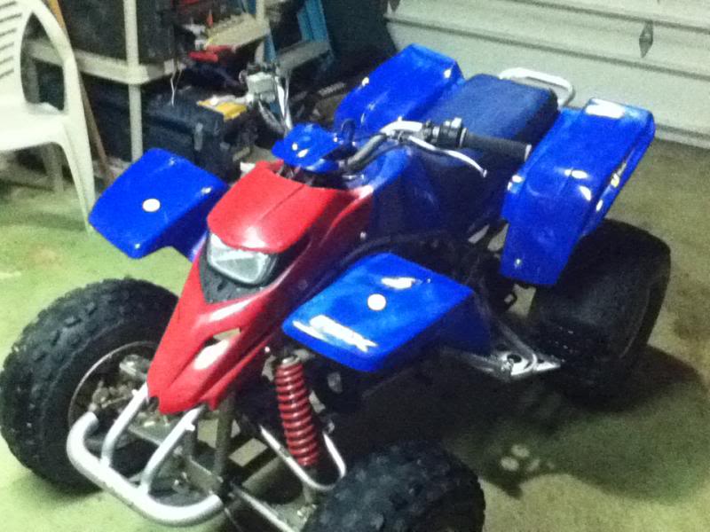

Here's the all blue minus my black wheels. I haven't had time to get the tires changed yet, but today's looking good since I'm on vacation all week.

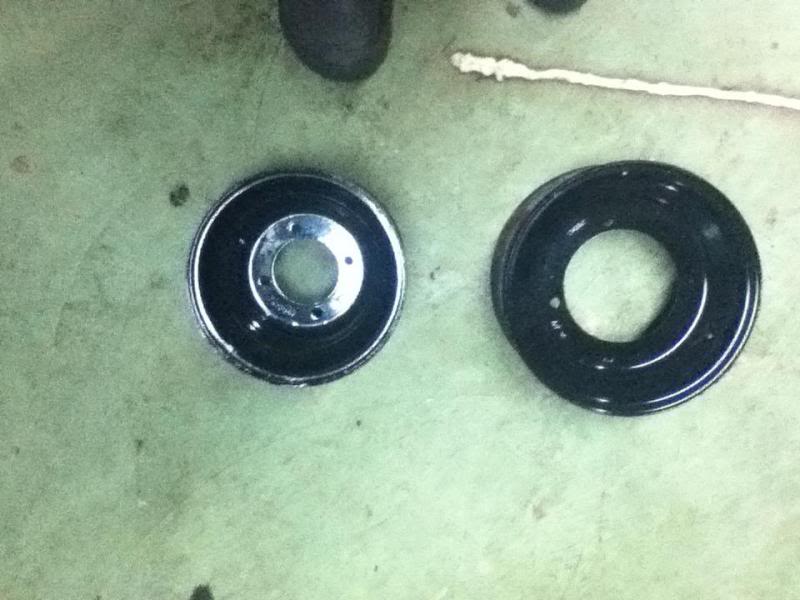

Here's 2 of my Gloss black wheels I rattle canned. I sanded all the rust off, 2 coats of primer, 3 of black, 2 Clear. They look nice now, but Ill get them all muddy quickly.

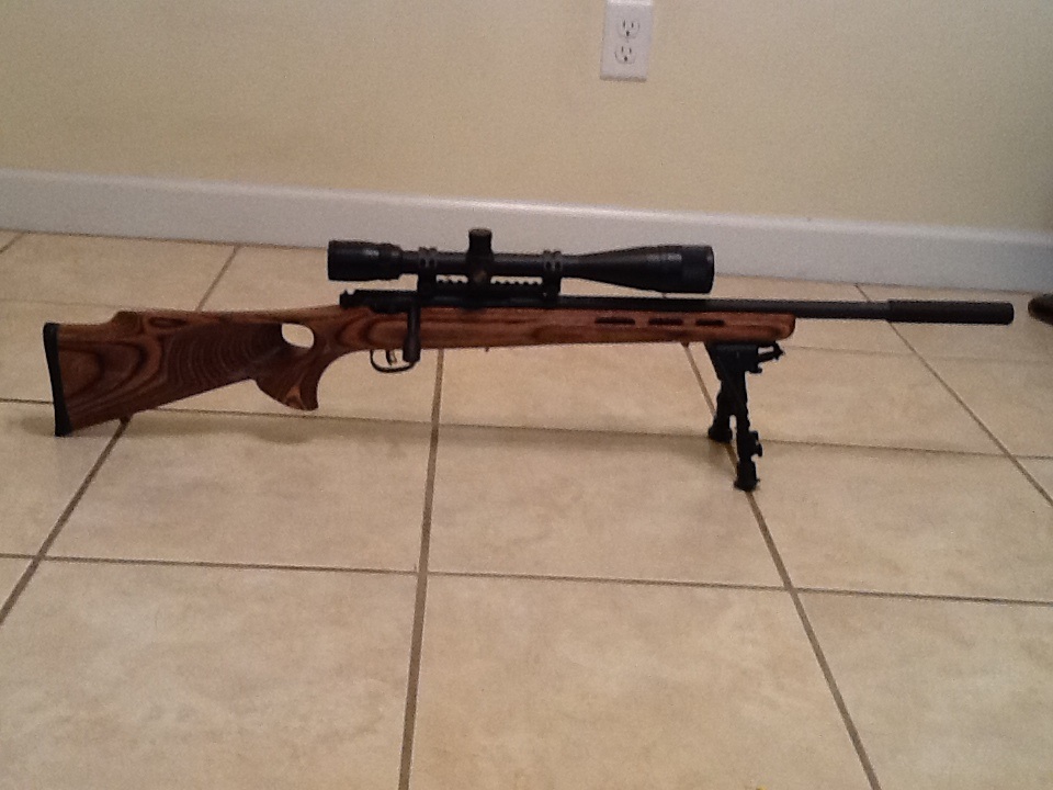

I love the Evo stock. My wife won't let me put it on any of my rifles tho. So for my suppressed 22 build I had to go with a Boyd's thumbhole.
Savage Mark II FV-SR with AAC Pilot 2 and a Bushnell 6-24x40 Mil Dot. Great for shooting any pennies within 75 yrds. Lol
My take on extra grease, which I believe is not required.
The bearing, itself, consists of an inner race, an outer race, balls and a cage which evenly distributes the balls. Common bearings are designed to allow for a radial load with some limited axial loading. ALL BEARINGS ARE LUBRICATED WITH OIL.
Grease, itself, is an oil sponge. The base (spongy) part of the grease varies depending on the manufacturer, temperature, environment and user preference. The grease holds the oil in suspension and allows the oil to flow during operation. The oil compresses between the bearing balls, inner and outer races and the cage, reducing friction. Ball bearings have small, microscopically rough surfaces on the balls, these surfaces move the oil, holding it to the ball during operation.
When too much grease is added, the grease is compressed between the bearing surfaces, increasing pressure and resulting with heat. Too little grease causes the surface friction to increase, resulting with heat.
If a bearing heats up any extra grease that cannot be contained within the seal will be expelled.
When the bearing cools the grease will be drawn back into the bearing, if there is any contamination of the expelled grease by water or dirt, this will be drawn back into the bearing, eventually causing its destruction.
The manufacturer puts adequate grease in their bearings. Just enough to allow expansion without expulsion, and enough for lubrication.
That is some interesting reading. I have never looked at it that way. Actually it makes perfectly good sense. Something to ponder on today........

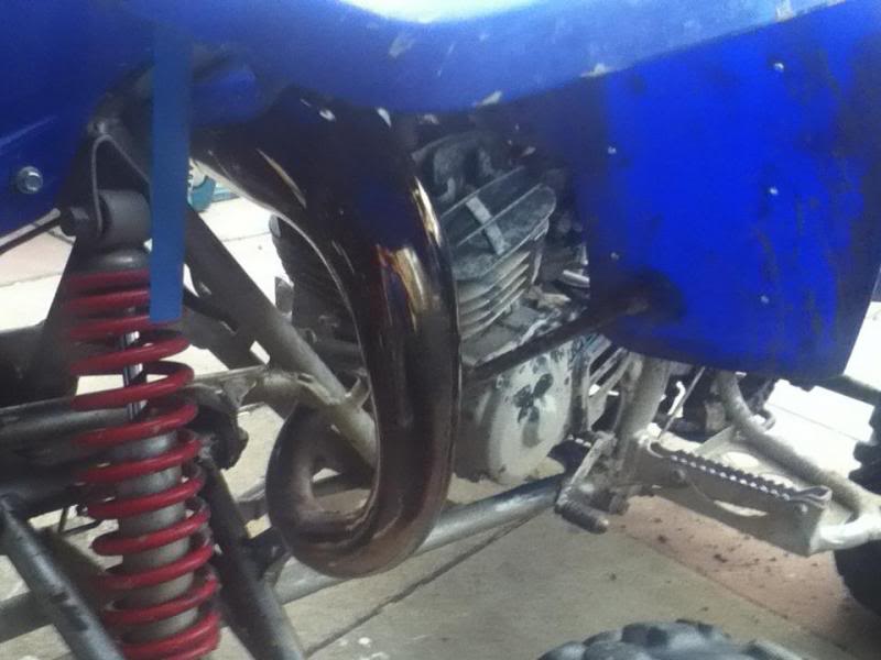

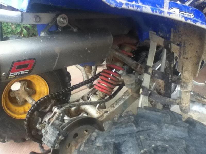

Today I Put the DMC Alien exhaust on. After some Jetting changes and 3 Plug chops, I got it running great. This pipe totallly changed the blaster!!!!! I Ended up Air screw 1 1/4 turns out, Needle Still in Middle slot, 290 main. I went across the strip mines about 2 hours ago and was shocked!! Sad thing is I bought some FMF tank decals on clearance for $20 bucks, Then I scored this DMC exhaust. Oh well! Here are a few pics.
