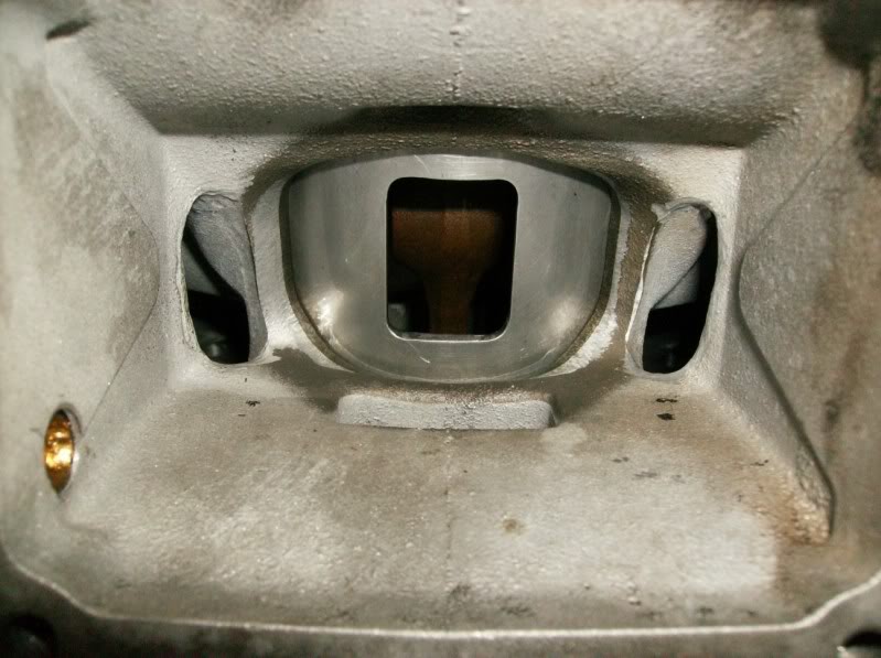

Since I cut a window in my flywheel cover I thought I might as well put a window in my piston while I had it out. Make it more interesting when it fires up again :)
